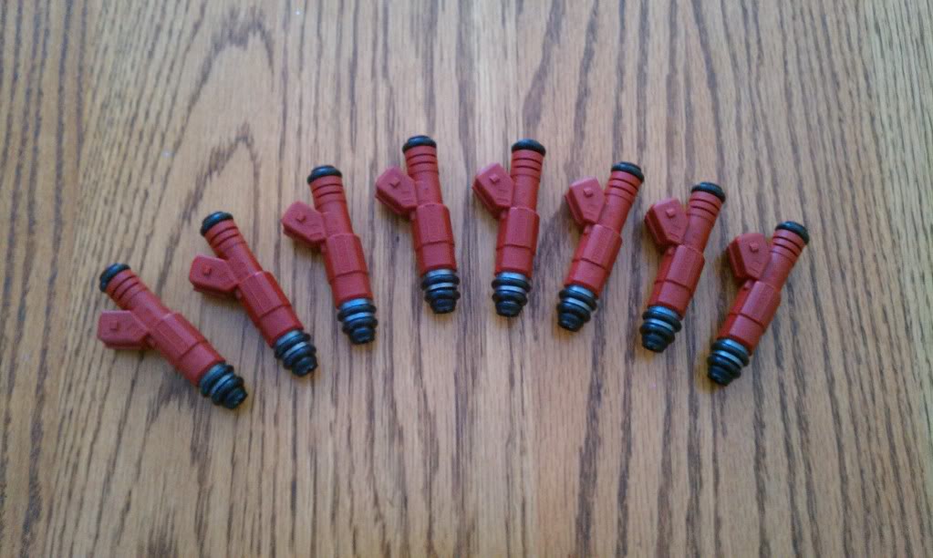

I picked up a refurbished set from these guys about 2 months ago for roughly $160. Great deal!!! Kinda a steal actually. Shipped fast too. Thanks Southbay.
