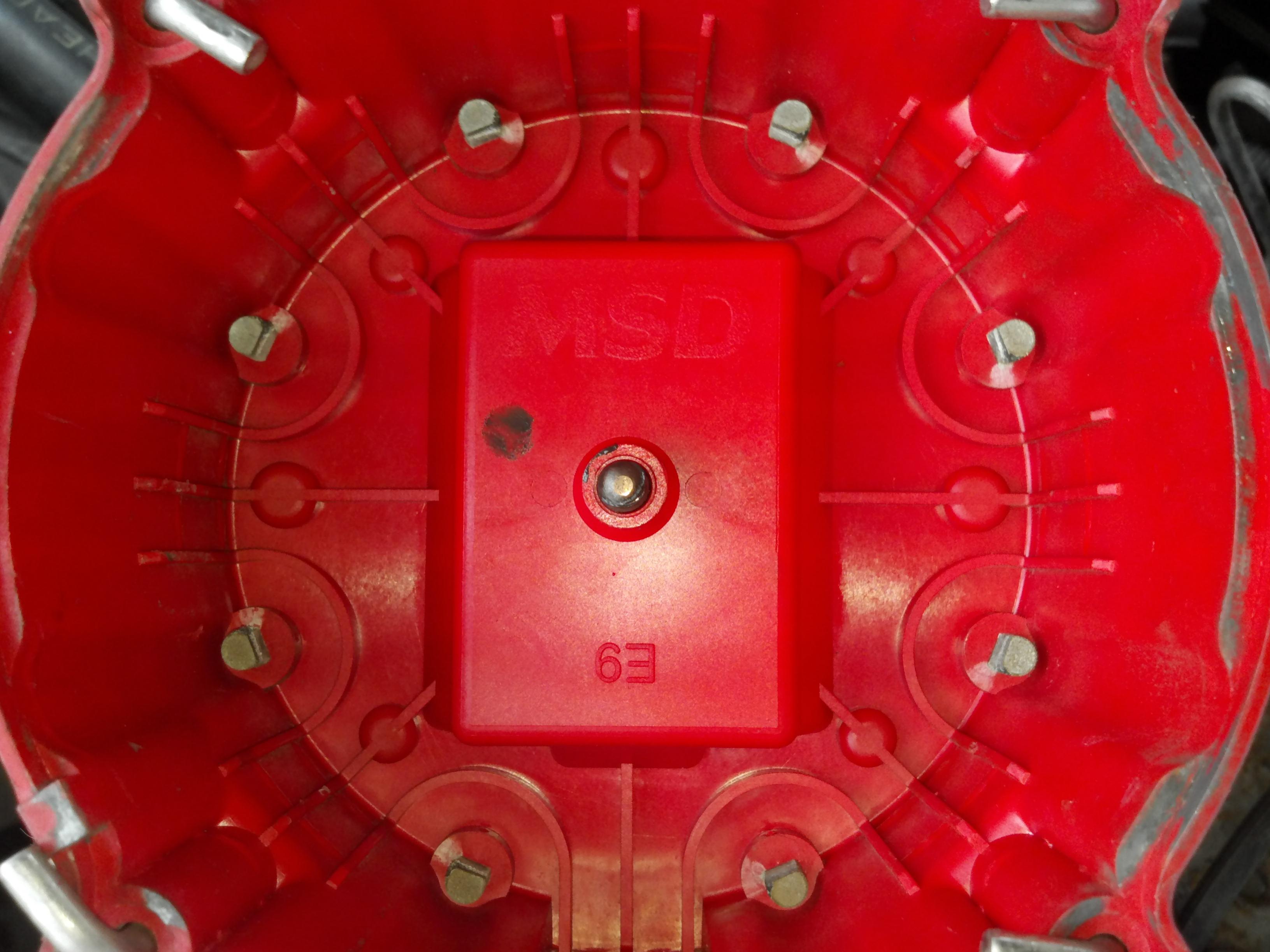

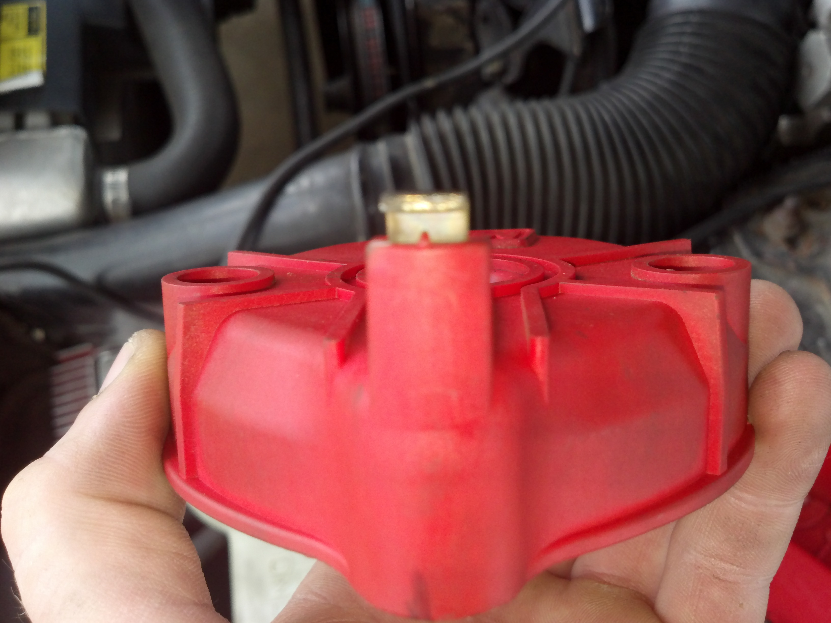

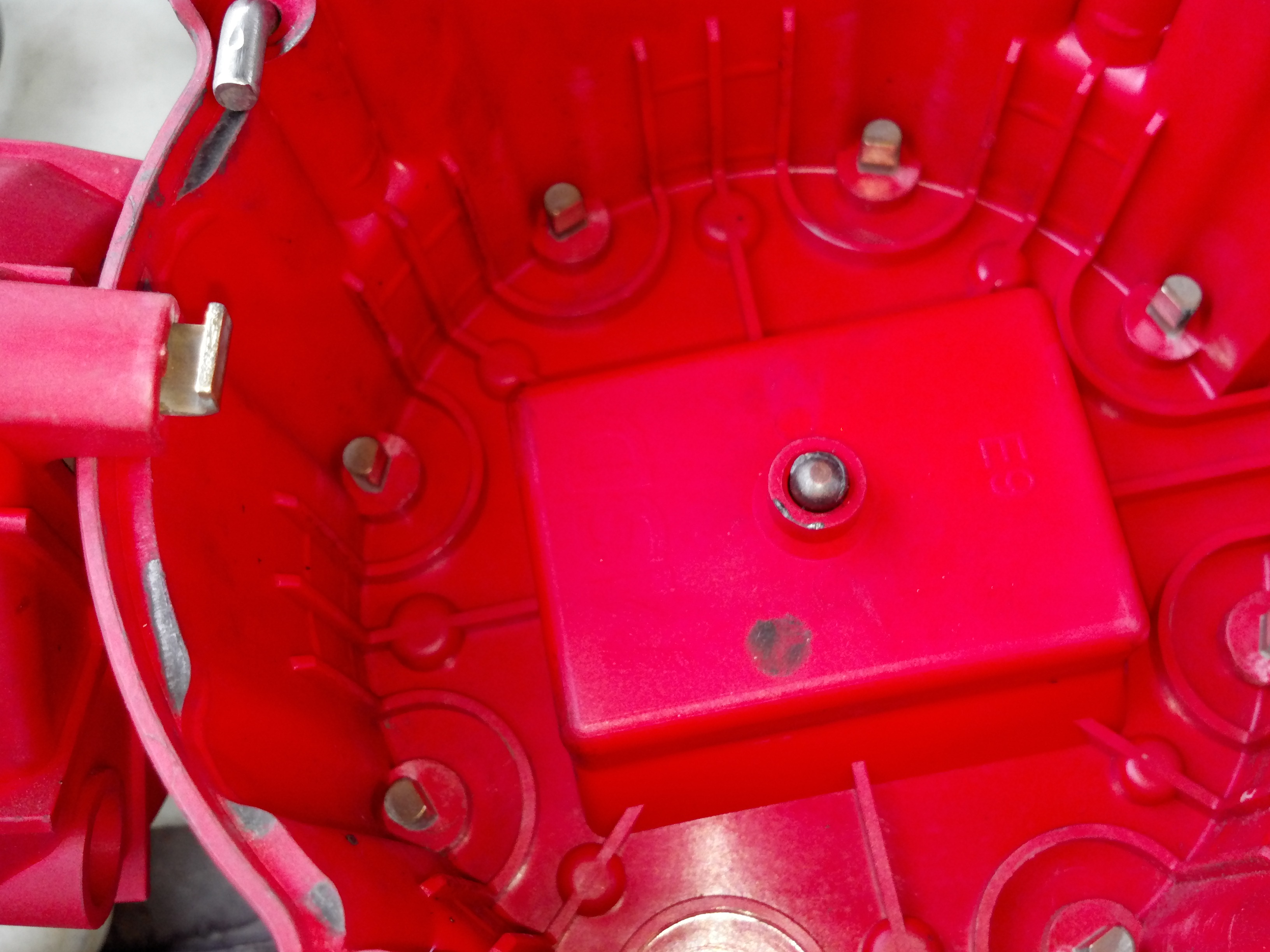

UPDATE: I've done some more poking and prodding on the car. As stated above when the MSD box was taken out of the ignition circuit, the car wouldn't start. I checked for spark with a timing light, and it flashed. BUT I remember having a similar issue a few years ago when it appeared I had spark but the spark quality was not good (couldn't jump the .060" gap). So I used my handy spark tester set at .060" with the MSD out cranked the engine, no sparky spark. Hooked the MSD back up, cranked, engine fired, but the spark wasn't a nice hot blue bolt of lightning...
Which brings me to my next theory, the coil is at fault, or atleast beginning to fault. I tested the coil, as per my '86 service manual, and read 0.46ohms between C- and B+ terminals. The manual states "Reading should be zero or nearly zero. If not, replace coil." I suppose this is not nearly zero?
I feel the MSD box masked the failing coil by doing what it does best, boost spark energy (or something of the sort).
As far as the cap and rotor are concerned, they both looked to be OK with no carbon tracking in the cap as evidence of arcing. I did clean up the terminals under the cap with a dremel and wire wheel.
