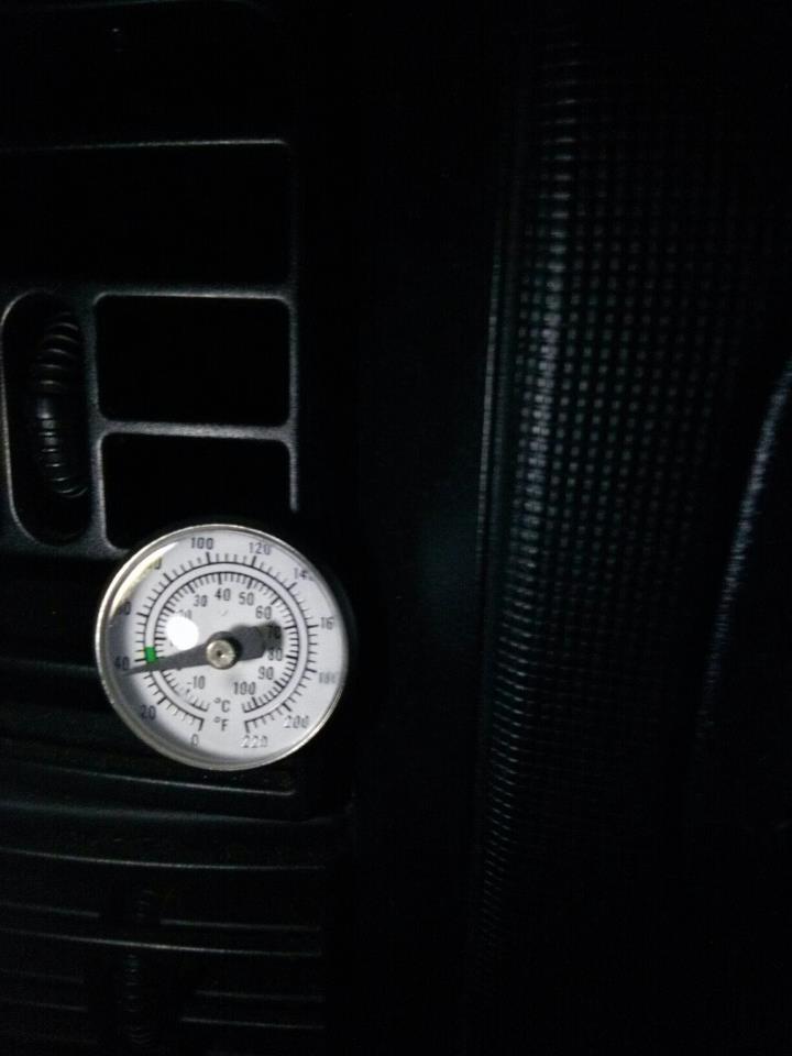

I will add a few other comments. While he has good luck with the orange/red orifice tubes, the GM systems respond very well to the Blue orifice tube from say a 1990 Ford Taurus with a 3.0 V6.
I personally adjust the cycling switch once I get the system properly charged and cycling correctly. Its been a few years since I have adjusted one, but from memory about 3/8 of a turn counter clockwise will drop the pressure it cycles off about 5 psi and make the vent temps about 3* cooler before it cycles off. A 1/2 turn drops the pressure about 8 psi and makes the system about 5* cooler at the vents. Most systems with a properly adjusted R12 cycling switch with R134a in them will blow about 48*F. 48*F does a poor job of dehumidification and cooling will suffer. I prefer to see vent temps in the 38-40*F range. My 03 Dakota gets down to 36*F before the compressor cycles off. The lines actually start to frost over before the compressor cycles. That was with the truck sitting at idle in 100*F ambient temperature and the a/c fan on high with a cooled down cab after my 45 minute drive home.
Attached Thumbnails 134 A/C conversion-36f-vent-temp.jpg
