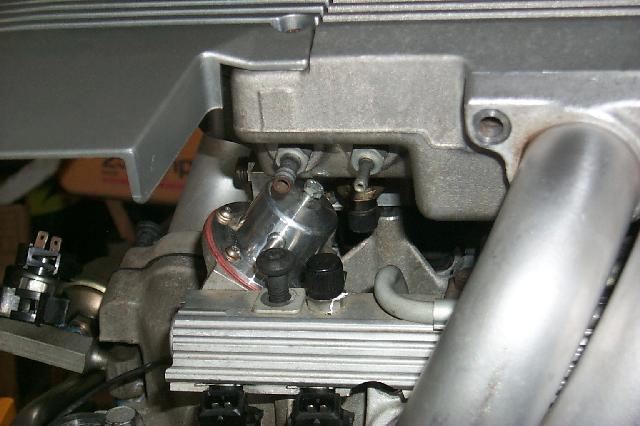

The regulator is on the fuel rail. Pull off the vacuum hose to it & watch for gas to come out.

The fuel rail holding pressure after the fuel pump shuts off was barely reliable when these things were new. There is a check-valve in the factory fuel pump system that's supposed to prevent back-flow through it. After tens of thousands of miles (and decades of time) they just can't be relied on to work perfectly any more. Fuel pressure will bleed down after the fuel pump shuts off. Some will do it quickly, some slowly, but they all leak back.
Bad regulator, leaky injectors..... sure, anything is possible in those areas as well. If it runs OK, it's probably not injector problems. The regulator could have a ruptured diaphragm (do ex-x-fire's check, above for that issue) or it could just be leaking past the regulator valve itself.
The question really is..... does it hold fuel pressure if the engine is running and does the engine run well at idle? If so, the problem is likely a minor one (small-leak back at the FP or regulator) not worth getting too twisted up over.
