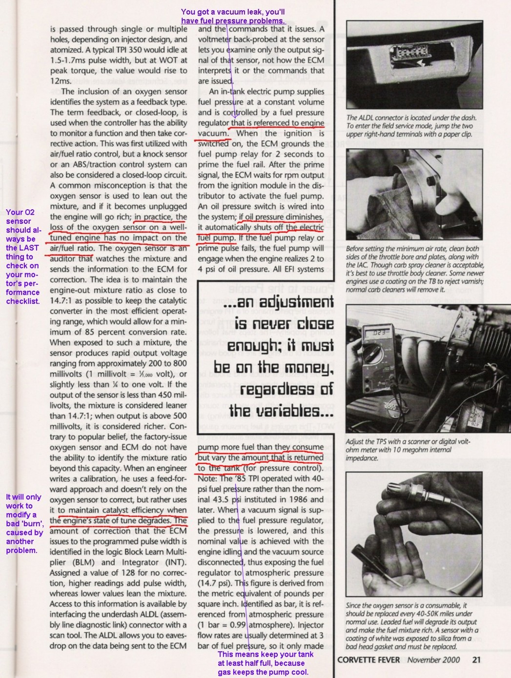

Originally Posted by Schrade
On a properly tuned motor, the O2's really don't do much more than go along for the ride...
Un hook the o2 and hook up a vom, with the engine above 146F assuming the o2 is still in the exhaust manifold you can watch the o2 swing if its steady at 450mv it is bad.
Looks like by the 'I don't understand smiley', that you don't understand.
Code:
edit:
And you manipulated MY quote. You put the 'huh' smileys in MY quoted post. You
need to remove them from MY quote. I understand FULLY.
The 'huh' smileys go in YOUR post, not mine, such as I have 'corrected', above.
Thanks.
Maybe Ray B can explain it better:
In other words, if you can LOSE it, and it has no impact ... , then it's a safe assumption that if working, and the motor is properly tuned, then for the most part, it's just going along for the ride.
Hope this clarifies your mis-understanding.
Knowledgebase OUT!
ed.:
Got the rest of the article if there's interest. I love sharing knowledge!
Also note that Ray says, Above certain throttle opening %, ECM IGNORES O2's' input:
(you could say that O2's are just goin' along for the ride )
]Maybe Ray B can explain it better:
To bad there are so many mistakes in that article.
The OP switch for example will not turn off the fuel pump with low oil pressure because the pump has a separate independent supply from the pump relay run by the ECM
Old Aug 12, 2013 | 12:16 AM
vetteoz's Avatar
iTrader: (13)
Joined: Apr 2005
Posts: 7,736
Likes: 14
From: Not in Kansas anymore
Car: 82 Z28
Engine: 383 SP EFI/ 4150 TB
Transmission: T400
Axle/Gears: QP 9" 3.73
Re: is it my o2 sensor?
"Loss of the O2 sensor a well tuned engine will have no impact on the AFR "
Maybe"Ray" should have read O2 sensors 101 before writing the article.
The O2 sensor is the most critical element in a ECM controlled engine.Without it the ECM has no feedback what the engine fueling is doing
"The computer uses the oxygen sensor's input to regulate the fuel mixture, which is referred to as the fuel "feedback control loop."
The computer takes its cues from the O2 sensor and responds by changing the fuel mixture. This produces a corresponding change
in the O2 sensor reading.
This is referred to as "closed loop" operation because the computer is using the O2 sensor's input to regulate the fuel mixture.
The result is a constant flip-flop back and forth from rich to lean which allows the catalytic converter to operate at peak efficiency
while keeping the average overall fuel mixture in proper balance to minimize emissions. It's a complicated setup but it works.
When no signal is received from the O2 sensor, as is the case when a cold engine is first started (or the 02 sensor fails), the computer orders
a fixed (unchanging) rich fuel mixture. This is referred to as "open loop" operation because no input is used from the O2 sensor to regulate the
fuel mixture.
If the engine fails to go into closed loop when the O2 sensor reaches operating temperature, or drops out of closed loop because the O2 sensor's
signal is lost, the engine will run too rich causing an increase in fuel consumption and emissions.
A bad coolant sensor can also prevent the system from going into closed loop because the computer also considers engine coolant temperature
when deciding whether or not to go into closed loop."
