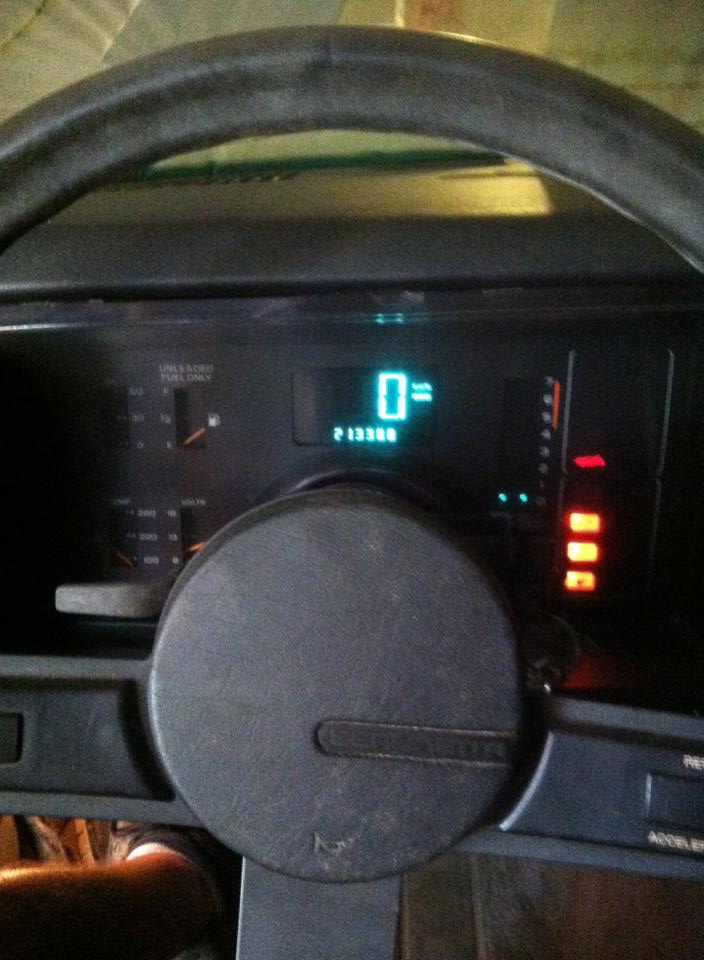

This was the only pic I had of the display.
I spent the day hooking up sensors/electronics just to check that they worked..snapped only one picture. Go figure.
It's way too cold here to work on her (heater went out in the shop) so it'll be a bit before I can snap more pics. I'll be sure to put them up when I do though. I'm glad you guys like my project!

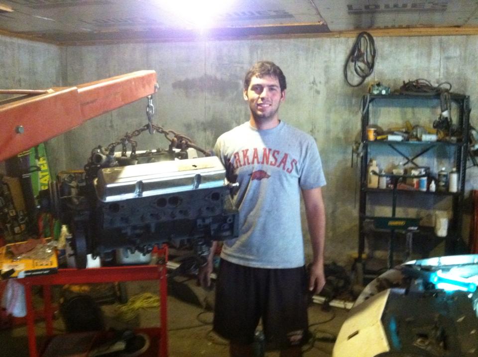

Some more pics for your viewing pleasure.
Installing the engine and a pic of the Contempo lid. Also some of my dads old cassettes! Grew up on glam/hair metal! \m/
Keep the advice rolling guys, my list is growing!
