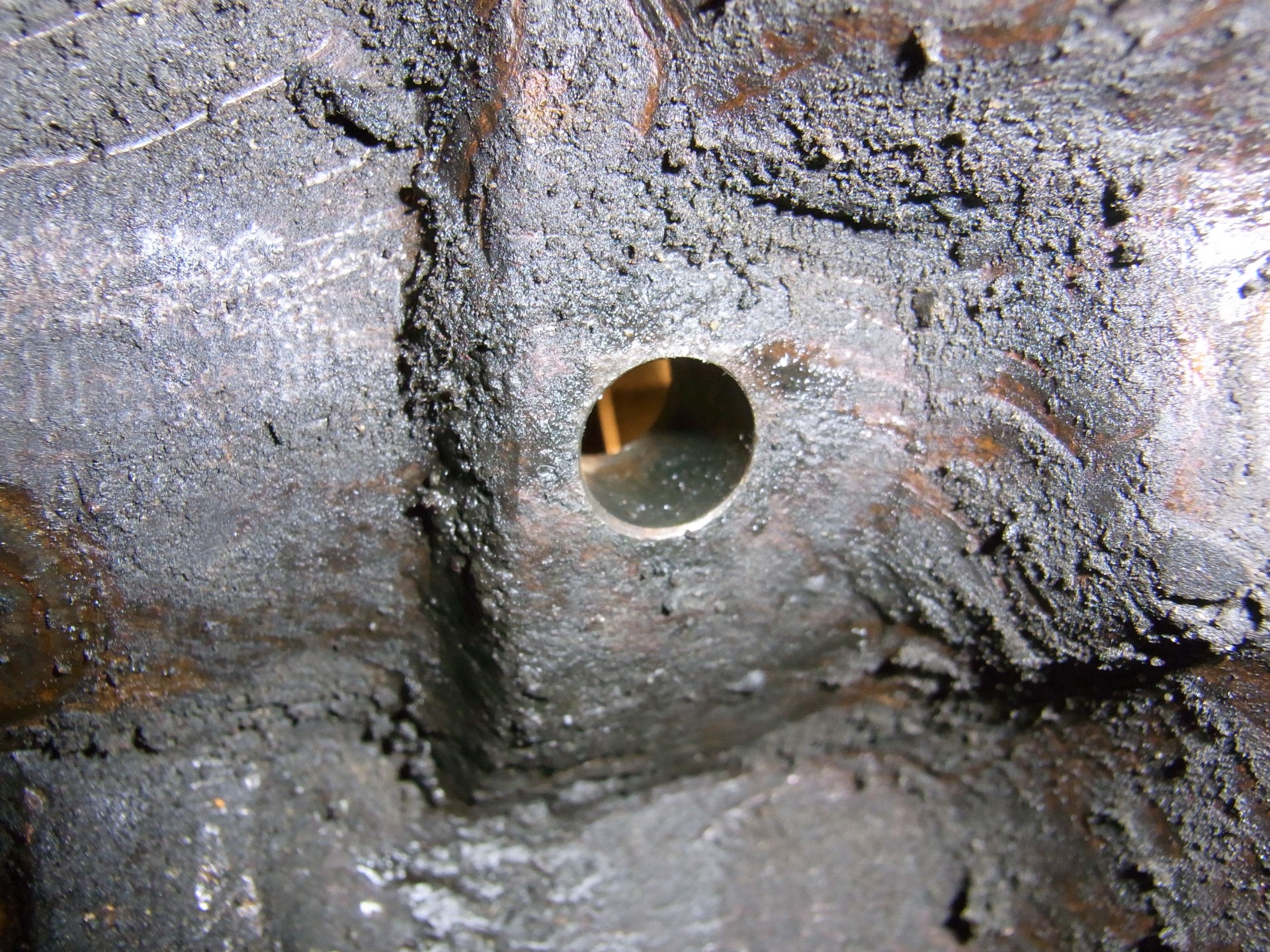

While waiting for the electric pump to arrive, I changed the mechanical pump as well. Now the engine starts quicker than it did before. I used to have to crank it for at least 15 seconds, and it would stall the first two or three times I put it in drive, before it would go.
When I was changing it, I noticed that one of the bolt holes in the front of the engine is open. I belive I have read somewhere that this hole goes through, into the space where the fuel pump lever is, which connects to the crank house. Obviously this isn't good, but how bad is it?

That hole is very bad because it goes into the crankcase where the PCV will be sucking dirt into that hole. Get a bolt into it right away. Put some thread sealer on it as well. The surprising thing is that it doesn't look like it's been leaking oil. Make sure that the bolt you put in it is short so it won't interfere with the fuel pump rod.

The bolt hole at the front of the block doesn't seem to go anywhere. I tried to get my camera down there, but it was too cramped. So I took a q-tip and probed around in there. It felt to me like it bottomed out about half an inch or so in, and there was no oil or anything on the cotton. I guess maybe they plugged that hole on roller blocks.

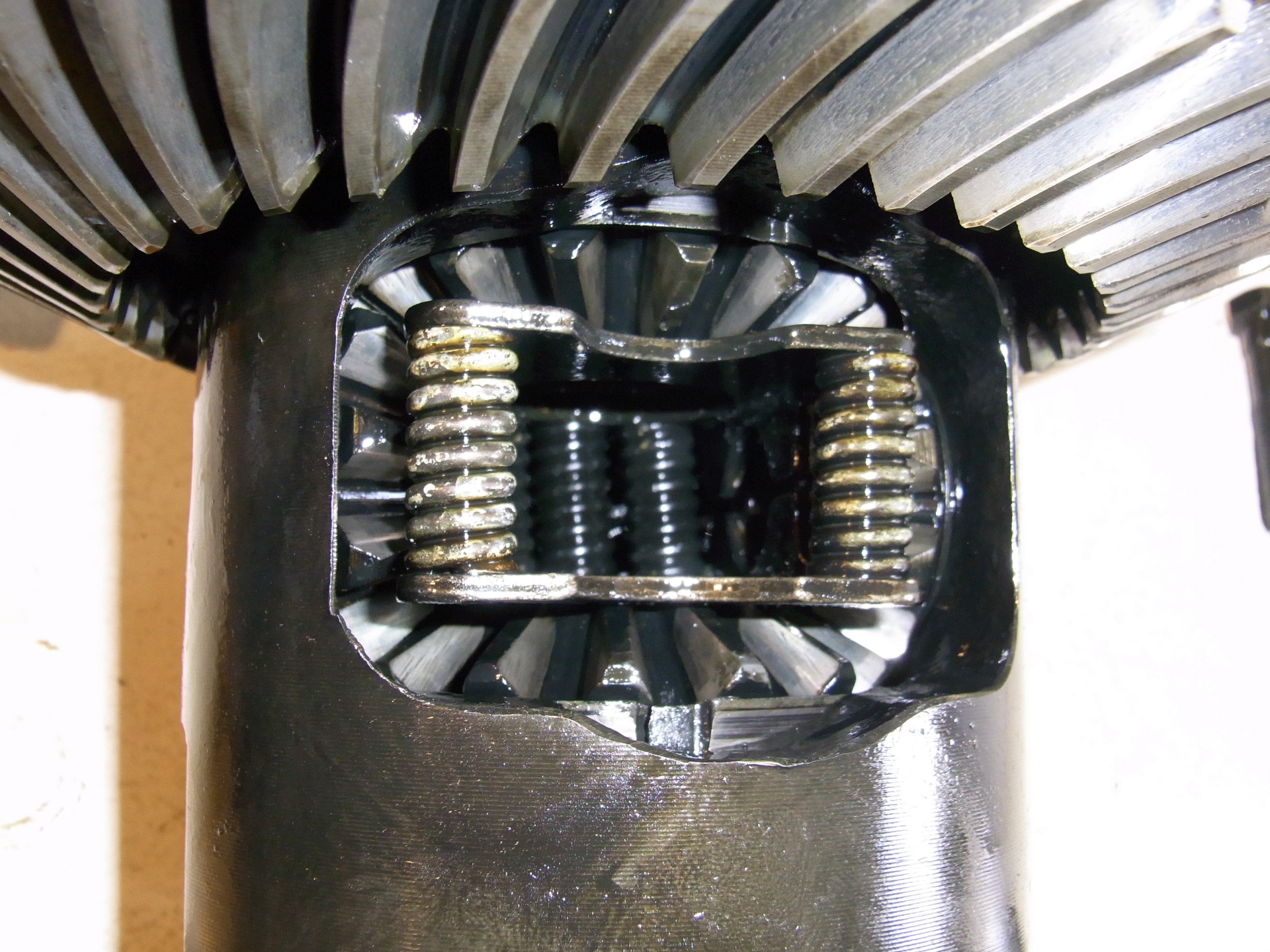

I've decided I can't deal with the transmission people right now. Mainly because I'm about to install a TrueTrac in my rear end, so I have enough on my mind. Pluss, I can't exactly drive out there now, with the rear end pulled off the car

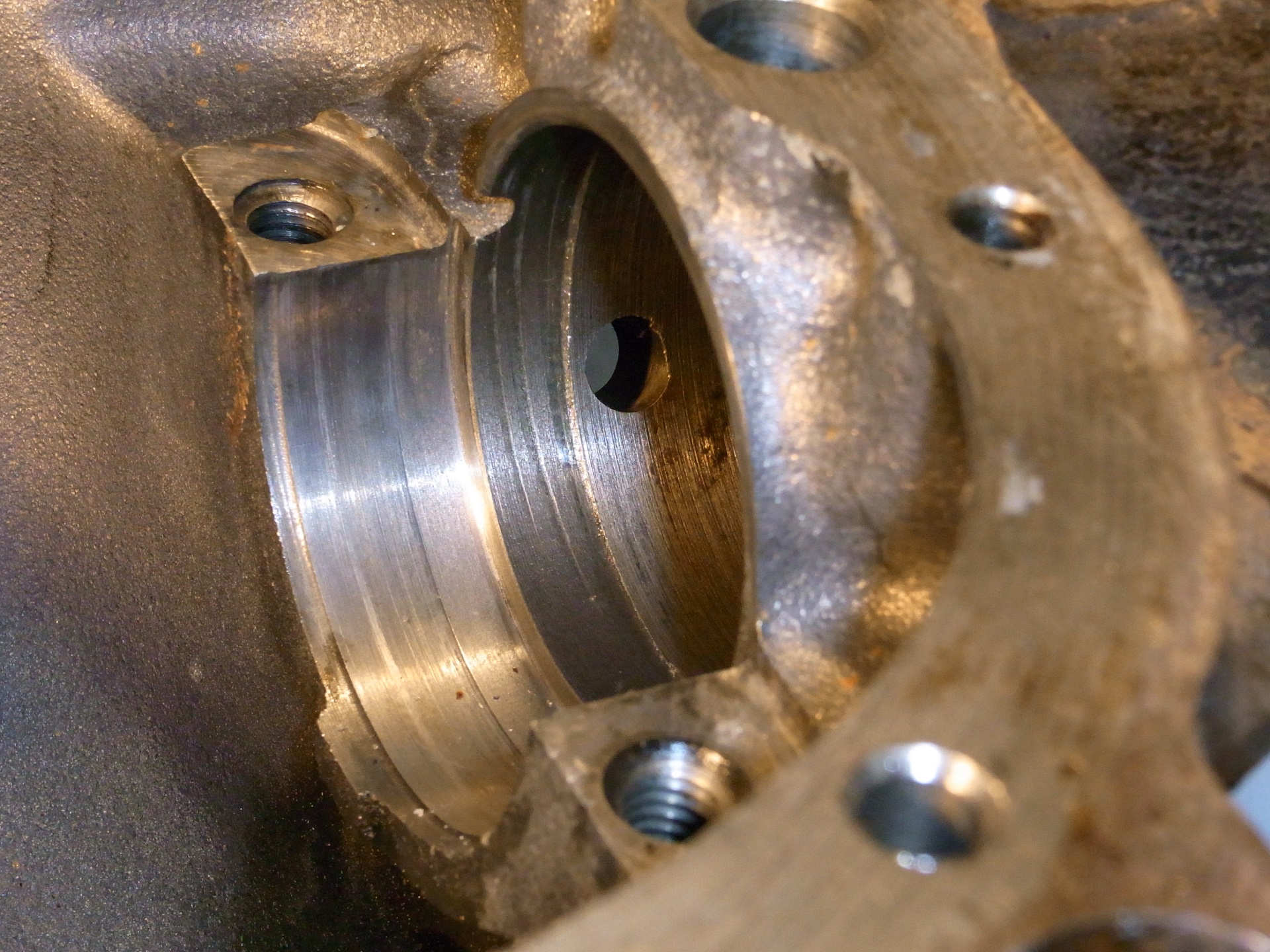

I've got the rear end out of the car, and the old carrier out of the diff. Now here is something to note. First off, the pinion nut was not tight, like at all. Secondly, after I removed the carrier and started cleaning in there i discovered a hole in the rear end. Looks factory, but what do I know. There was nothing to plug this hole with! Anyone seen this before? What and/or why?

I did read up on that a while back. Can't remember it all, but at the time I had a clear image of how it worked, and how to set it properly, which I believe I did. But I also recall something about needing the valve itself to be set properly by the installer (in this case the transmission people) before the cable adjustment could be made. ****, now that I think about it, he did mention something about a kick down wire being out of adjustment when I first got it back (took two more tries for them to get it to where it is now). I hope that guy didn't actually think it was just a kick down wire.
Man, I'm getting all worked up over this. Can't stress out when I'm about to install a fresh new LSD and gears. I don't want to rush this job to say the least.
So, if anyone else knows anything about the hole in the differential, please let me know.

But back to the rear end. Up untill now, I was pretty sure I had an open diff, as it would spin one tire, never grip etc. But mine has a bunch of springs holding plates together between the spider gears. Does that mean I actually had (obvoiusly not working anymore) a posi diff?

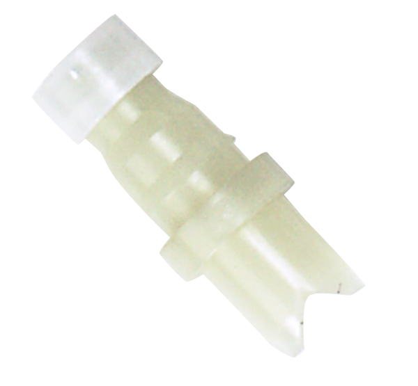

Yes, that is an Auburn posi; probably stock; probably not doing anything anymore. Those aren't known for durability or longevity. And naf is right, they are not repairable. Time to chunk it and get something good.
The hole in the diff pumpkin is the vent. There's supposed to be a ... vent ... stuck in it.

Guess I need to find a new vent then.
I allready have a brand new Detroit TrueTrac with 3.42 gears from Yukon waiting to go in.
Thanks for the quick reply

Regarding the vent, I found some pictures of it while looking up the original part number (GM 1236317). Looks to me like its just a sort of breather with a cap on it to prevent foreign materials from entering. Suppose I could replace that with anything suitable. Or is it more sophisticated than it looks?

That looks exactly right; nothing real elaborate.
I'd suggest putting the right thing back in there though. Can't cost much, or alternatively, snag one at yer local buzzard nest. That'd be a lot smarter than something that might fail and let the fluid all get flung out again. The inside of a rear is a pretty violent environment after all.

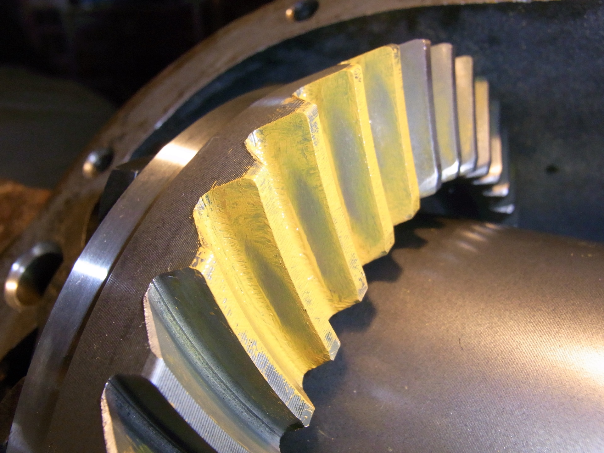

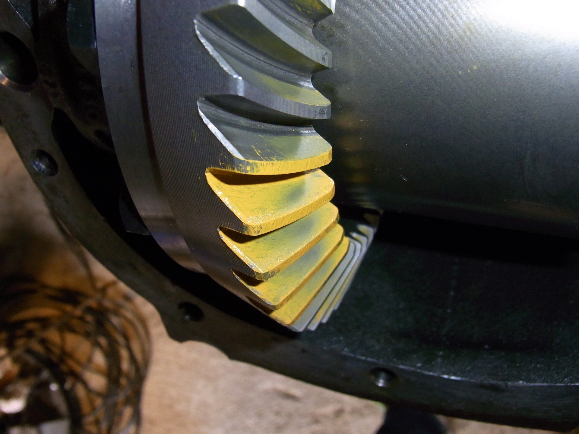

Quick update:
Got the Truetrac in, and set it up to where I think it might be close. What do you think? The installation instruction that came with the Yukon stuff tells me that this is an acceptable pattern, but the examples that they deem acceptable vary quite a bit.
Backlash is at 0.007". All the preloads are set as well.
I hope this is a good pattern, but this is my first rear end rebuild so I have no idea what is within range and what can improved.
