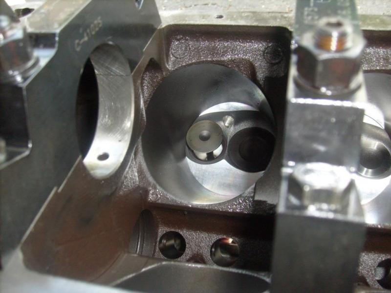

Sorry I am late to the party. I always love these heated discussions (not rly) - To the OP, I can tell you I LOVE the idea of a stroked 305 TPI. The lower ci seems it makes better use of the TPI from a total airflow perspective, but the stroker takes the "higher revving wanting" smaller cubes and "tames" it for TPI. In a way, the darn thing makes sense for that intake.
Someone said all the 305 builders ditched the 305 for something else... Well yeah, and lots of the 350 users ditched the SBC for an LSX. Looks like you get to waste money just like everyone else!
Anyway,
Here's the real problem... actually there are a few I dont like if we are allowed a decent conversation without bs.
1) Pistons. The kits I see use some crap pistons and while I agree cost should be kept to a min. for this, I still have YET to see someone do the stupid idea right and actually put some good **** on and in it. This makes me wonder if someone did mid 13's with mostly stock stuff.... what can it do when someone loves on it? 2) The pistons most offered simply WANT a 5.565" rod. WHY!!? WHY do we get stuck with those rods and cannot use a 5.7 or 6.0 like the 383's IF we are talking the same stroke and deck height? I am not a HUGE rod ratio junky but I do believe this has a lot of truth to it for longevity and dwell etc.
I tried to find said pistons and I think I found a dished set somewhere but I will have to check my bookmarks on my old lap top. ALL the pistons I found were dished. No flat tops which is what I wanted for Fastburns... anyway.
So far pistons and rods.... Next was the TFS heads. They arent what I wanted but they will work great for a 305... Not so much for a "leap forward" head. Will they work a 383 ok? yeah sure... But after getting a 320rwhp 334ci in the high 12's a 383 wont run much better with TPI and those heads. You will most likely want what everyone else has IF you even do another SBC. BIG heads and BIG ci. So basically using all this crap on another engine is out for me...
I will let you know that if you are serious and not just having a moment like I do here and there... I support the idea because there is no doubt in my mind done right, this motor will be awesome to drive. TQ everywhere, well behaved and make a fun car that wont get torn up too bad.

I also have a file showing the TFS heads on a 305. From the mains.
The valves appear to be moved for less shrouding. Again, on the ol lap top. I'll dig that crap up if this thread shows any interest.

Here are some shots of Trick Flow 175cc heads on a 305 bored 0.030" over (3.766" bore). Via Casey butt
First with 1.94" and 1.50" valves seated. The combustion chambers measure 3.955" across at the widest and overhand the 3.766" bore a fair bit. The intake and exhaust valves appear equally close to the cylinder walls and the valve spacing is around 1.91"
Next, the 1.94" intake valve opened until it contacts the cylinder wall, which occurred at 0.771" lift.
The 1.50" exhaust valve opened until it contacts the cylinder wall, which occurred at 0.728" lift.
Take home:
You can use these heads, stock with 1.94" and 1.50" valves, with up to any practical maximum valve lift (0.771" and 0.728"). You can use these heads with 2.02" and 1.60" valves on a 3.766" bore as long as the valve lifts are less than 0.433" and 0.507", respectively. That doesn't consider the effects of shrouding by the close proximity to the chamber and cylinder walls. Also keep in mind that these numbers will change depending on the exact depth of your valve seats.
For comparison, I did these same fits on GM 305 '601 heads here: https://www.thirdgen.org/forums/te...ds-1-94-a.html
In comparison with the GM heads it can be seen that Trick Flow widened the valve spacing and moved the exhaust valve closer to the chamber wall - this allows more lift with the 1.94" valve and less shrouding on the intake, but shrouds the exhaust a bit more and allows less exhaust lift with a big valve. Curiously, even though the TF head allowed more lift with a 1.94" valve than the 601, the 601 allowed more lift with a 2.02" valve than the TF, indicating that TF seem to have angled the valve slightly differently than GM, or my 601's had an "off" valve guide job.
Take home:
