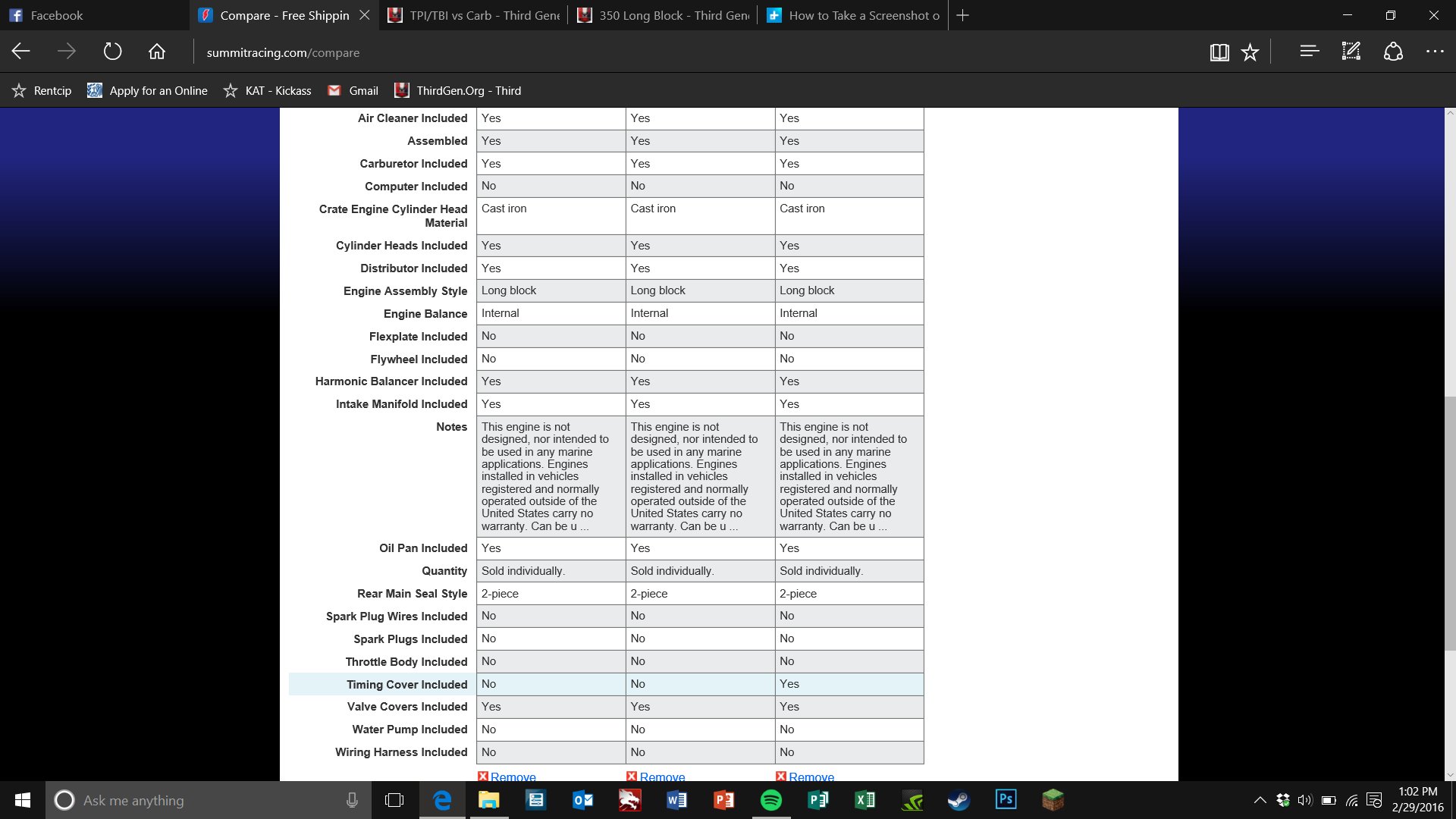

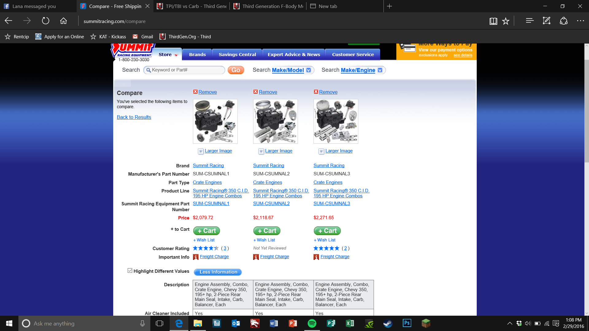

I'm looking to get a new engine for my 91 Camaro RS. Other then the price what is the difference between theseWhat's the difference-screenshot-2-.pngWhat's the difference-screenshot-4-.png

Different carbs, chrome timing covers....
for a 1991 I would NOT buy one of the engines listed.
if you are not using EBL or going to burn a chip you will need to stick with a 305 stock engine.
For the cash a 200 HP 350 truck engine might be your best bet if you want to go to a 350. You can use all GM parts to install that engine.
