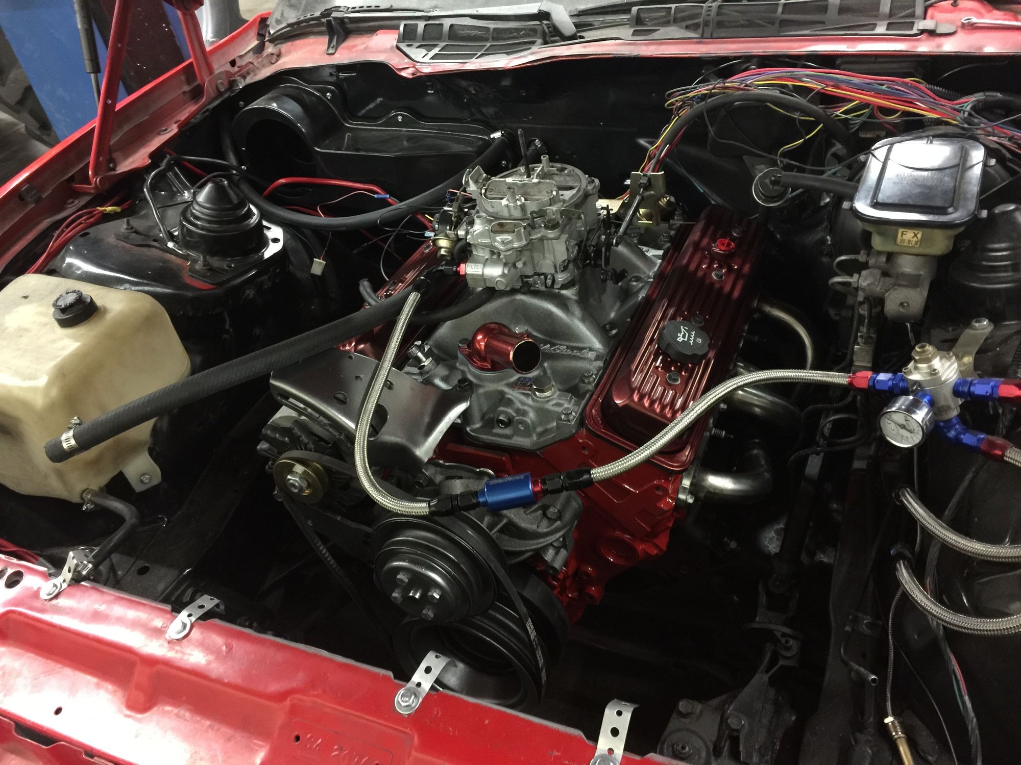

does my cable look right?
Not sure if you can see it in this pic. Car is a t5 so it's just the throttle cable

Re: No tension on gas pedal
Your throttle cable bracket is too close to the carb. You need to either modify yours or buy a different one.
Get a couple of return springs on there too.
i swapped in a new cable for a carb engine and I'll be having the bracket fabbed up tomorrow
