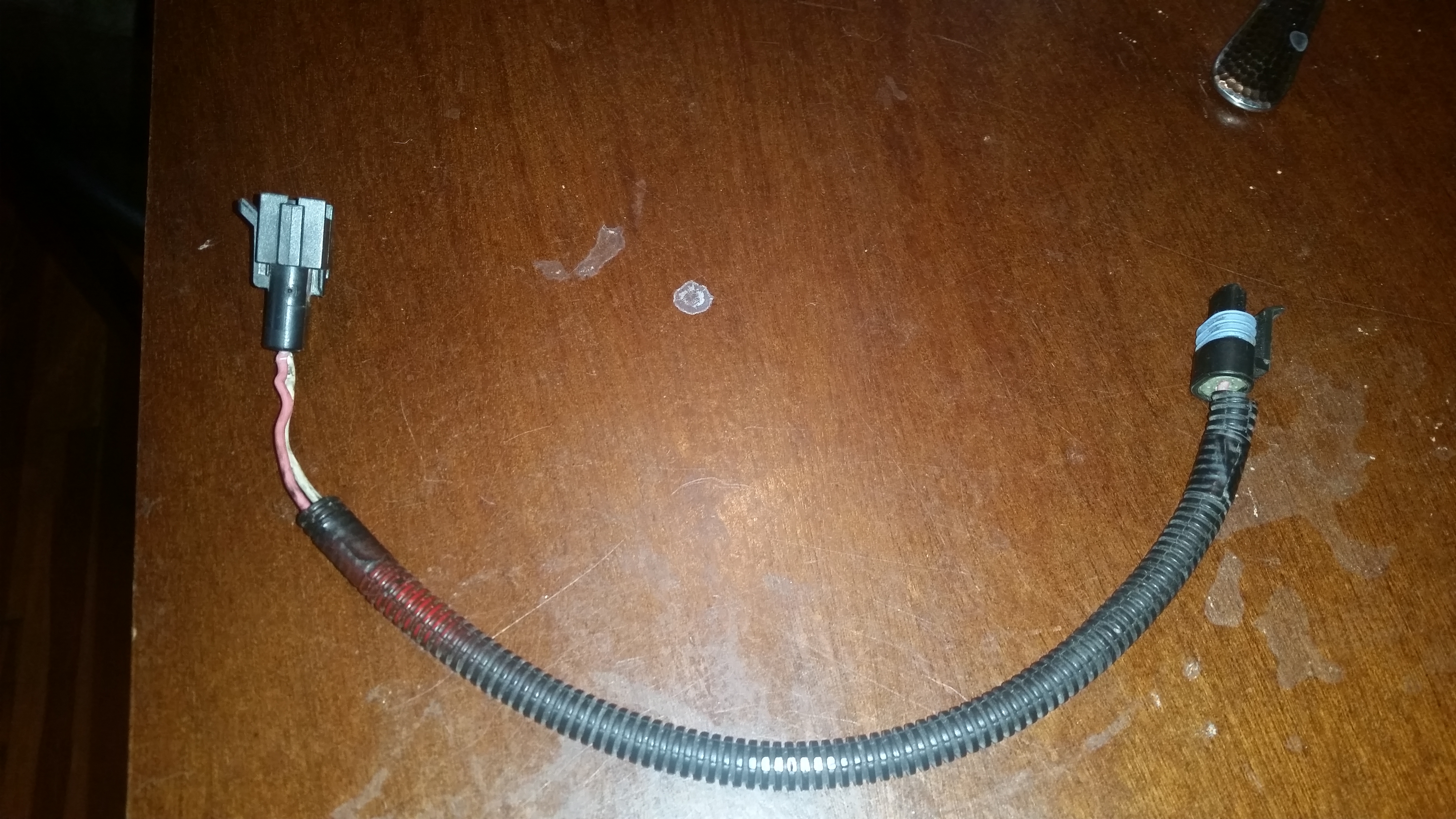

The wire that goes to the coil to the distributor an you still buy it a part store or do I need to go e bay or hawk the wire is cut on the bigger plug ?

If a replacement cannot be located, it is a standard PED connector. Pull the outer seal, eject the contact, and repair/replace the wire.
