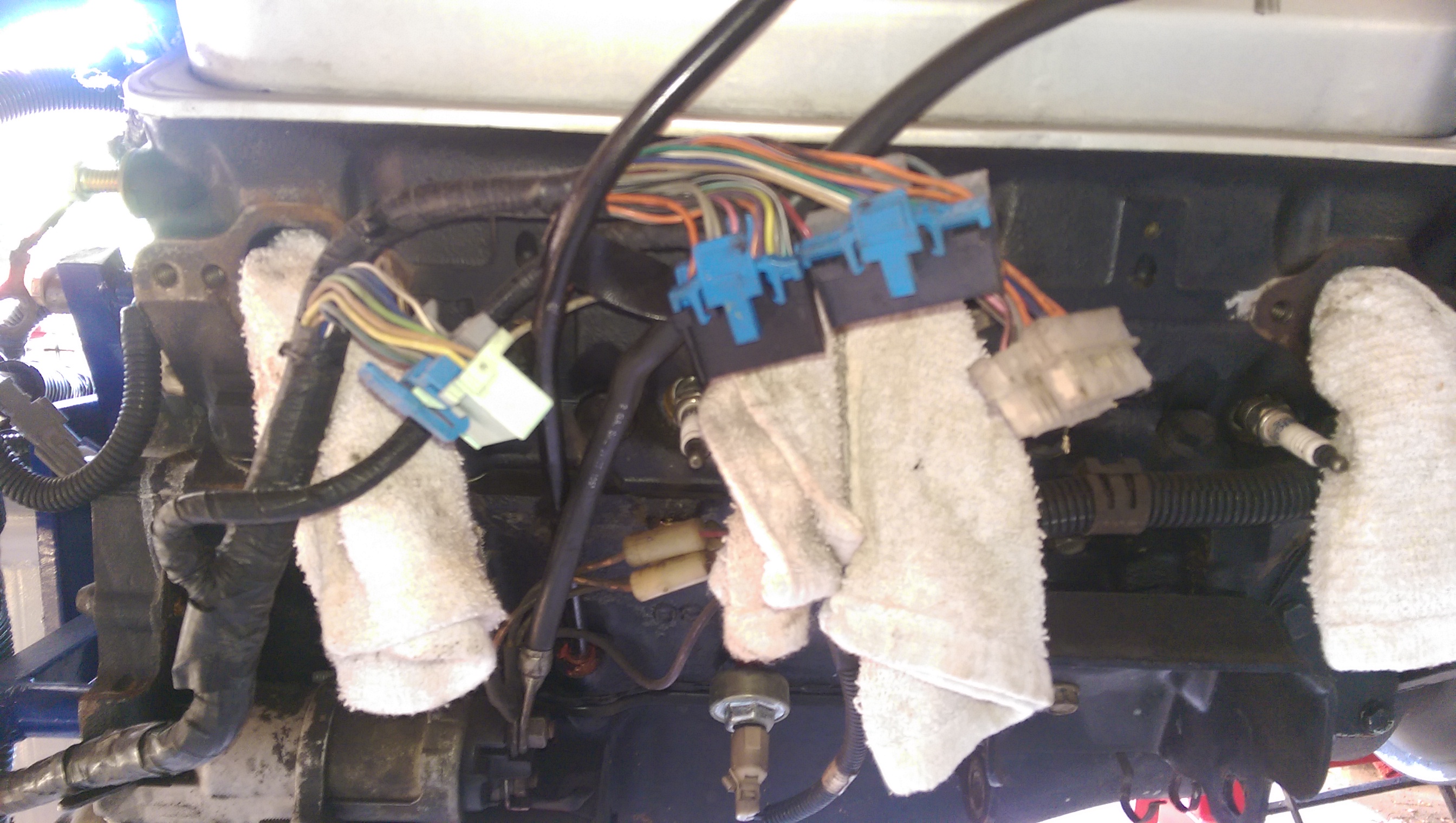

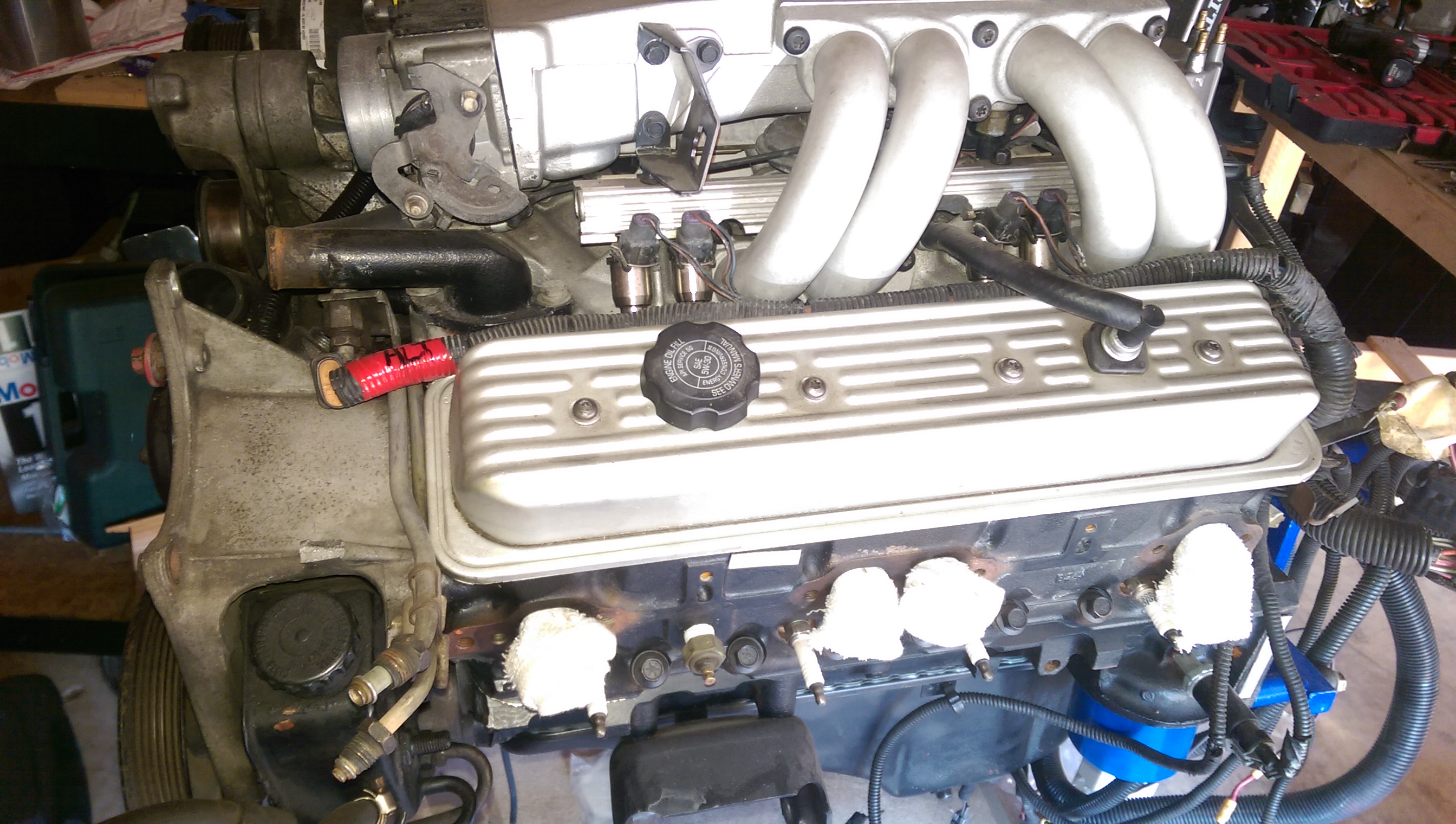

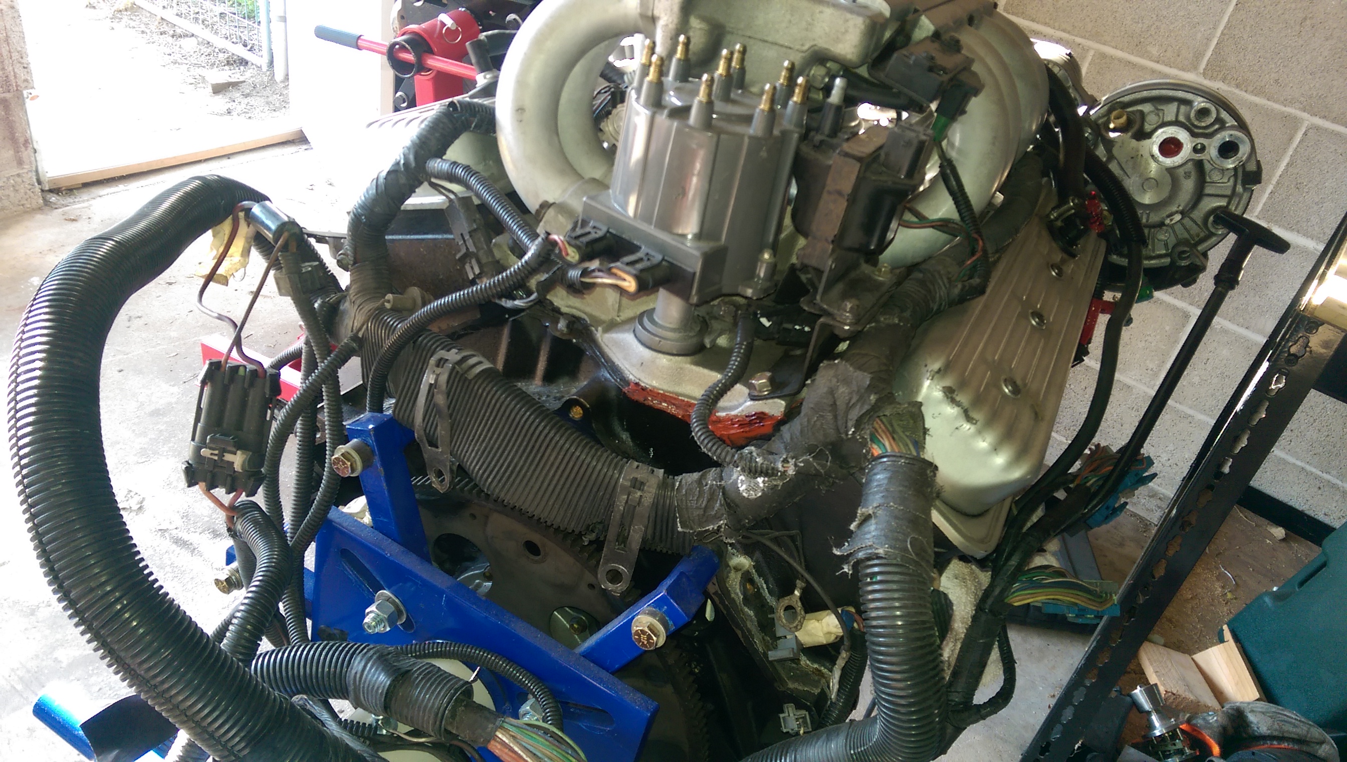

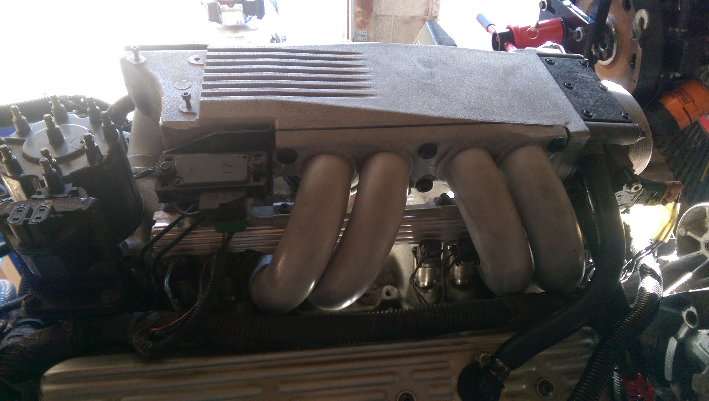

Morning all,
This is for SofaKingdom: I couldn't attach the pics and the data on the PM, so I posted this here for you to look at:
Block S/N: 10243880
Head S/N: 14096217
Looked up the block in the GM Block s/n listing and got this:
10243880: 350 2/4 bolt main / "ZZ4 Roller Cam" / 1-Piece Rear Main Seal
14096217: GM 350 / 1.94 Intake / 1.50 Exhaust / 64cc Crate Heads
Block S/N: 10243880
Head S/N: 14096217

Looks like a crate motor, not original L98. Possibly marine. Those heads are said to be close to the 083 casting in an overall way but I've never seen a pair with my own eyes so I can't verify that.
If they are, should be OK.
The 880 block is the same one used for about all 350s (except LT1) from some time in the early-mid 90s on up. Newer than these cars.
Looks pretty complete... accessories, harness and everything.
The spooge on the intake china wall is kinda amusing but you'll be getting rid of the rubber piece anyway so that won't be a problem.
