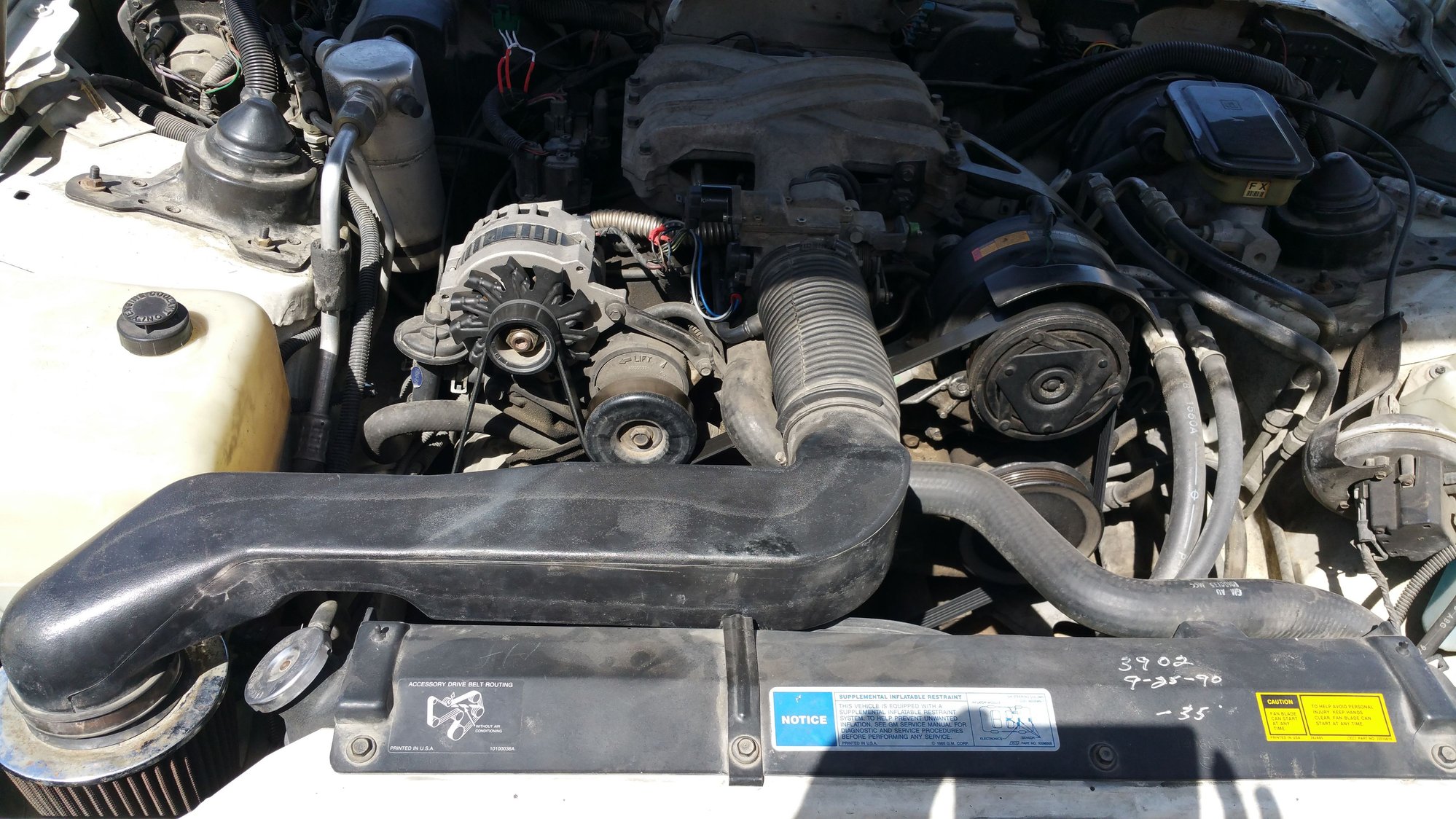

can anyone help me with a 1991 V6 3.1L Firebird basic engine diagram for someone that is pretty new to engines.

thanks for the response! my fan works fine. i don't even know what this part is. i'm trying to solve a stall from stopped when driving/intermittent check engine light issue. i took it to Midas and they changed MAP sensor, knock sensor, idle air control. i previously changed the throttle position sensor and the idle air control. Midas changed the idle air control a second time because they said the wires had shorted out the other stuff? sometimes the car runs fine and sometimes it hesitates and jerrks sometimes with a stall with RPMs all over the place before surging and taking off once it kicks in. i was told when i bought it 2 yrs ago that it had a slight vacuum leak. Midas says no and they keep trying to upsell ie. induction service i paid $150 for and car still has the same issue. Now they are saying it is the catalytic converter. I asked them about the EGR valve and they said it was clean. Hard to believe on a 91. Can u point out the EGR valve on my engine, its a V6? Here is
