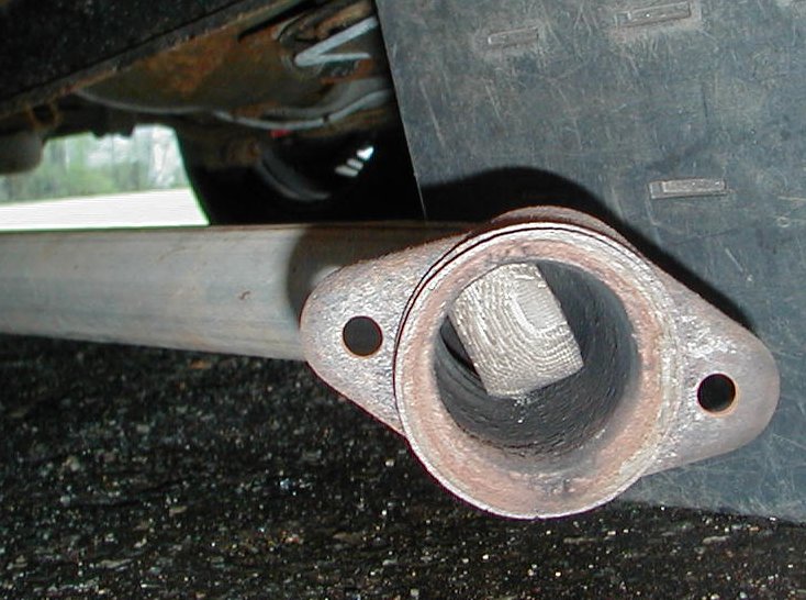

If the car sat for awhile then watch out for super-hot exhaust / manifolds due to a clogged cat converter or clogged pipes. The car will seem to run fine but will "die" at higher RPMs,....usually noticed when driving the car - but it could also happen @ idle too if the exhaust is real clogged.

I actually have the pipe cut for now since I had to remove the exhaust to get the tank off. And the converter is long gone the car has a bullet to replace it. I think it should be fine. I was reading up on some stuff and I believe the injector is at fault. I don't think it sprays gas once I start reaching that rpm. Im going to switch out the injectors they are old and hopefully that's the problem. But I'll check the pipes anyway
