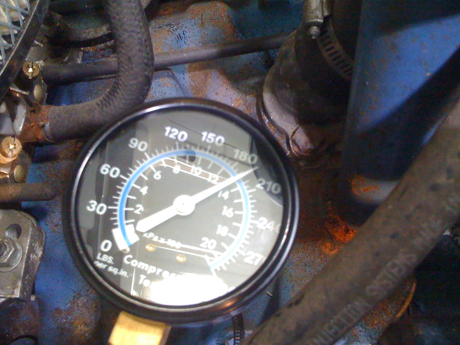

Low , here's a Friend's 1969 Rambler 390 at 75K miles , all cyls were within a few PSI of this .

It's a 9:1 blower motor. I meant more of the needle movement rather than the final pressure.

Ah , it's built for boost , got it .
As to the movement , it looked normal to me . I know that any time Ive ever done compression tests the needle usually bumps up once or twice to a final pressure like yours did , in fact I can't ever recall seeing one do one big push up to it's top pressure with no further increases , if that's what your asking .

Seems like it cranks slow? But seems normal to me

The #7 cylinder has a final psi reading of almost 10 lower than all the others. This cylinder was also glowing the header primary at idle. Trying to determine if it is bad injector, or valve issue.
As far as the engine rotating slowly, I've never been able to figure that one out. It's got 150psi compression which isn't high at all, and my bearing clearances are loose. Yet it is hard to turn over by hand or starter.
