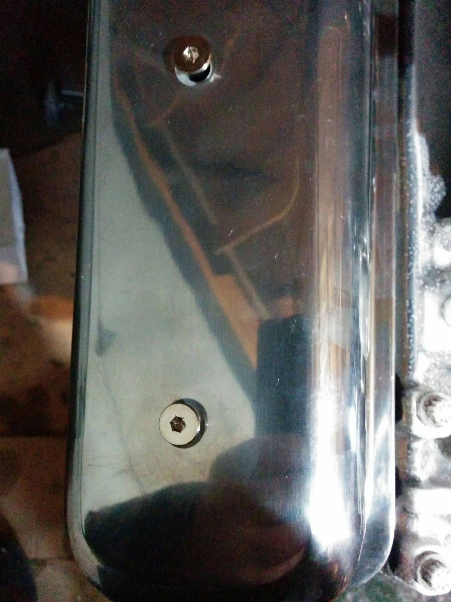

Hi Guys,
Purchased some new tall Mr. Gasket valve covers to provide some additional rocker clearance. Attempted to assemble today (after getting the forsaken gasket on) and I notice that I'm not able to drive the included bolts down tight enough to do.. Well, anything. The bolts are bottoming out long before they make any sort of contact with the valve cover.
I'm running Pro Topline 350C (Vortec) heads. I'm not sure if I'm better off just cutting the bolts to fit or if there's a better alternative.
Has anyone else run into this before?

Sounds like a plan. My first instinct was to cut them to fit. This is my first set of center bolt heads so I wasn't sure if this was somewhat common or not. I'd like to use these since they're stainless and they're flush mount. I was tempted to complain to Mr. Gasket but I figure they'd probably just blow me off anyways.
