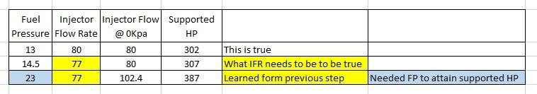

So I have a fueling question. I re read my WithchHunter datasheet. My injectors are 82# @ 14.5 psi. As far as the EBL_Utility is concerned I'm trying to fix my BPC numbers, this is how I extrapolated the numbers.
RBob, any comment on this?

Since only the short block is being changed, using the same cam & heads. I wouldn't do much at all with the BIN. First priority is to get the engine up and running and the rings seated.
Once that is done adjustments to the fuel pressure for more flow can be made. Along with the appropriate BIN changes.
The fuel pressure versus flow and HP supported you posted look OK.
As for the failed rod bearing, two things in the tune can do it. First would be excessive detonation (incorrect SA). That can pound out the rod bearings to the point of failure.
The other would be from excessive richness washing out the rings and diluting the oil. The fuel saturated oil doesn't work very well at supporting/cooling the bearings.
