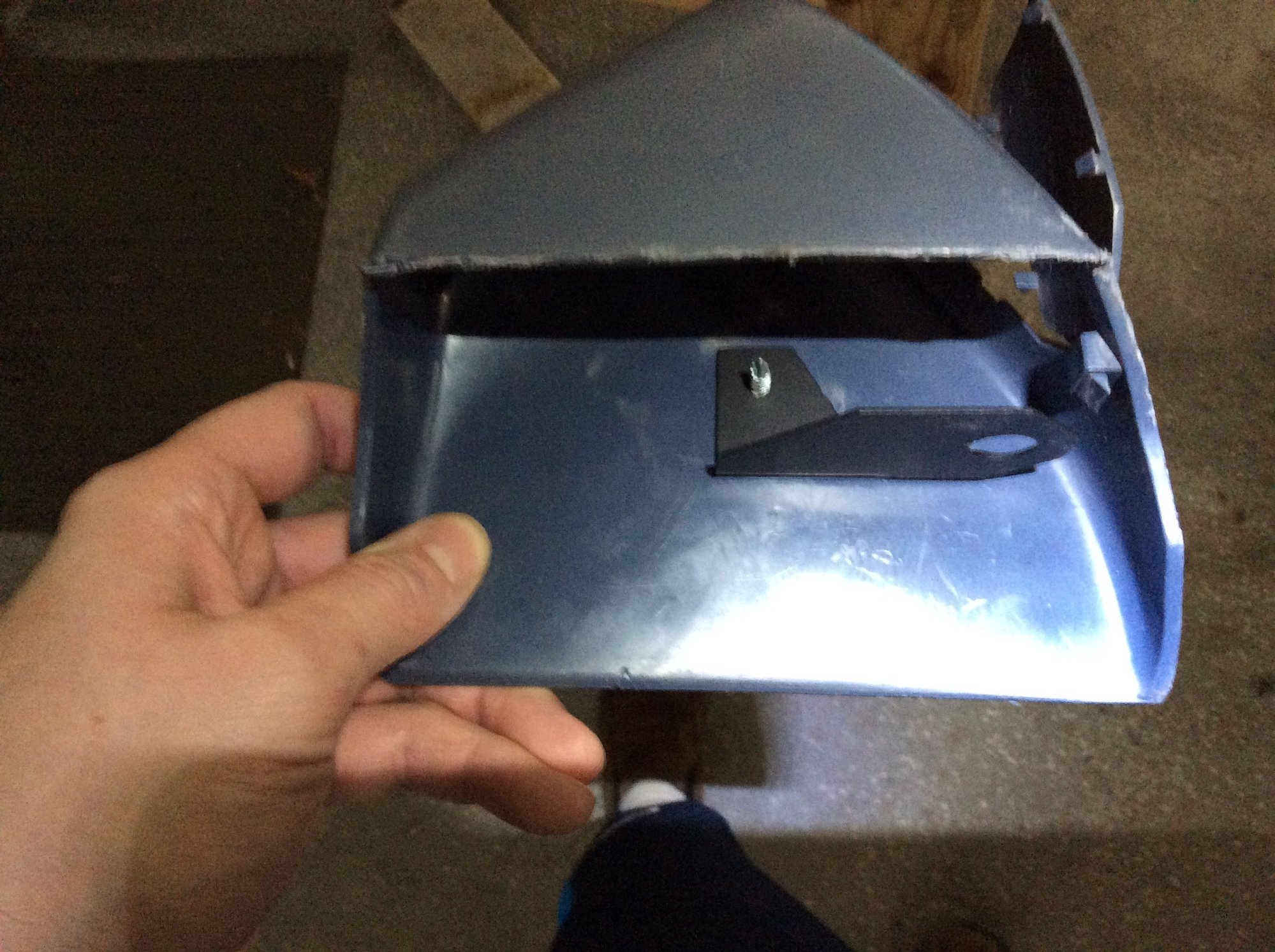

You drill out the rivet or rivets in my case on the bottom retractor to get it out of the housing, and insert a bracket that comes with the kit.
How the lower housing looks with retractor gone and screw installed with adapter plate. Screw faces the seat so you never see it, albeit a cheap design its a solution.

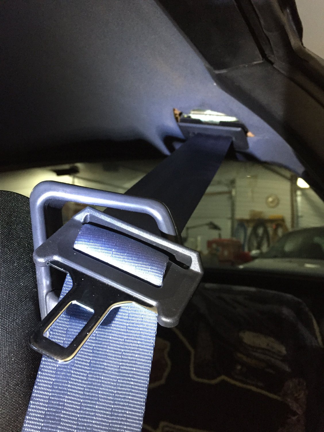

In terms of removal, my original headliner had some give, and i was able to get the old top retractor out. The install of the new one required bending of a tab in the roof structure to accommodate the wider plastic housing of the new retractor.
How it looks installed, with trim and where the buckle rests with its new configuration.

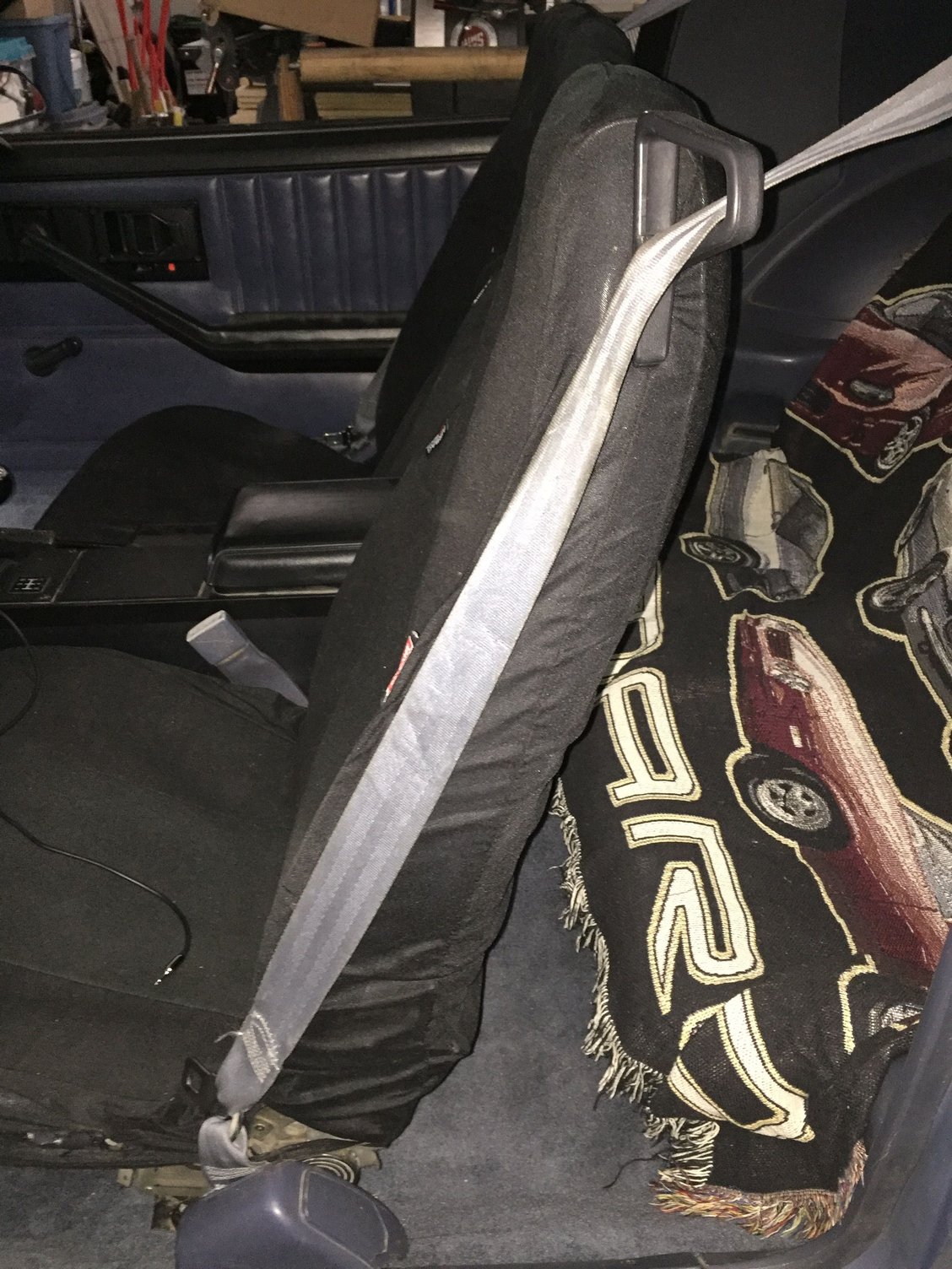

Where it was comfortable for me to be able to buckle up
