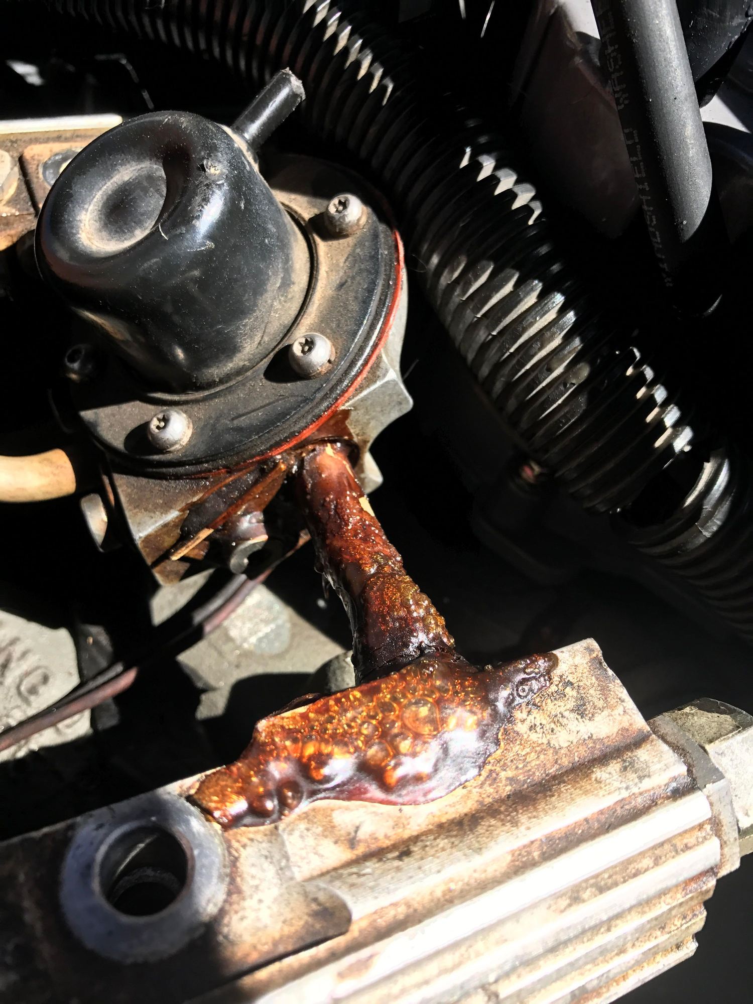

I can't find a thread on Fuel pressure regulators and I can't figure out how to ask a question or start a new thread. that being said, I replaced fuel injectors today and saw what looks to be the remains of an explosion/meltdown on my fuel pressure regulator. is thing trashed? new regulator and rails now?
