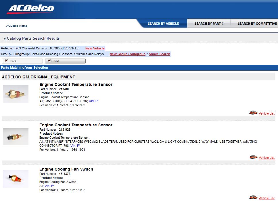

They don't differentiate between a 305 TBI and 305 TPI. Also they group all of the temp senders and switches together. Also ACDelco usually carries a generic line and an Original Equipment line. Seems like the "Professional" listing is generally the generic replacement.
Best bet would be to look up the sensor you need in a more specific catalog. Not the easiest website to deal with, but ACDelco has an online catalog that might point you in the right direction. Or look up the sensor you need in the Parts and Illustrations catalog and cross it over to the current replacement, if there is one...
ACDelco catalog screenshot...

Hey Drew, I checked the website as well.
The OE and Professional both list the 213-928 so I'll just go with that one.
Thank you!
