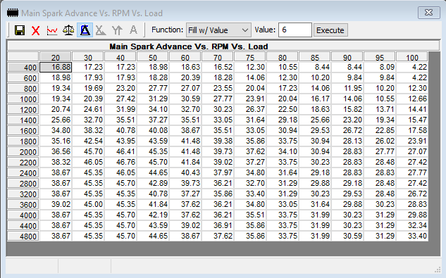

Pretty soon after I installed my SuperRam about a week ago, my datalogs started showing increasingly-high knock counts: on 7/29, my datalog showed about 1.4 knock counts per minute, but my last log today shows 18.3 counts per minute!
The weird thing is that these knocks occur at low RPM--they are very heavily weighted along the 1250 RPM line--and almost exclusively within the first 5-10 minutes of the engine running (more if the engine was cold to start, less if it was warm). I'm only running about 25 degrees of timing in the worst-affected places, whereas other areas of my tune with as much as 40 degrees of advance show no knock counts.
I initially chalked this up to piston slap from my forged pistons, but when I realized that the knock rate was rapidly getting worse I began to get concerned. Another observation that pointed against piston slap is that I still see knocks when I start out with a hot engine (200 °F startup coolant temp).
My VE tables are fairly-well dialed in (within about +/- 4% of 128 BLMs in the affected area) and I've tried pulling as much as 10 degrees of timing with no effect.
In the early stages of the engine running, when knock counts are still rapidly rising, lightly revving in neutral gives a few knock counts as the RPMs fall back down. Another thing I thought was interesting is that the graph of knock count shows gradual increase punctuated by large bursts of knock count-- one instance in my last log showed 42 counts in 10 seconds. Other than that, I don't really see any patterns in the data.
I can't say I know what detonation sounds like, but I don't notice any "marbles in a coffee can" noises or really anything abnormal.
Please help me track this down!
Only knocks at low RPM
Knock counts in my last 5 datalogs

I pulled some more timing, and I'm still seeing the problem. On my last run, I still saw 13 knock counts in cells where timing was 10-15 degrees and 43 knock counts from 15-20. I've dropped timing once more so the max in the range I'm seeing knocking is 10° advance, so we'll see where that gets me.
The weird thing is, I saw this problem (of a smaller magnitude) before installing the SuperRam. Same deal--knock counts in a straight line across 1250 RPM--just with about a fifth the total knock counts.
Is there a way to make the mix richer just in those cells, or do I have to use the scalar to adjust the target AFR across the board?
Thanks for all your help (here and on the Corvette Forum).

I just ran another datalog with the spark table maxed at 10°, and I still got 12 knocks in cells with 5-10° advance. Same deal, clustered around the 1250 RPM line. Interestingly though, I had knocks in the range of 15-30°, when the spark table in those cells clearly commands only 10° advance. What's going on here?
I only had 21 total knock counts though, so it seems to be an improvement. I can't say for sure that isn't attributed to starting with a dead cold engine, though.
EDIT:
My real hangup here is that the knock counts are purely RPM-dependent. I have cells just 300 RPM away from where I'm seeing knocks that have 25° more timing, and they're not knocking. Granted I know a whole lot less about engines than you do, but to me that seems like a rotating part is hitting a resonance and causing false knock right around there, is that possible? Come to think of it, I failed to rebalance my flywheel for my new engine. I don't have any noticeable engine vibration even at high RPM, so I shrugged it off, but could it be causing this?
EDIT 2:
Went on another datalogging run (same tune, but I dropped closed TPS spark advance from 16° to 10° in a couple cells) and kept having knock. Interestingly, it looks like my adjustment to the closed TPS advance shifted the knocks higher up in the kPa range--whereas they were focused around 40 kPa before, now they are located more around 80 kPa. So it appears that timing does have an effect on this, which would seem to eliminate it being a false knock. However, about a third of the cells with knock counts showed just 6-7° of spark advance! These were all about 20% throttle at 1300 RPM, for a pressure of ~70 kPa.
I'll pull the plugs, and if I don't see anything abnormal I'll go back to a more driveable timing map and drive with one wire off at a time to see if I can track down a bad cylinder.
I'd like to take my car somewhere tomorrow, and I don't have much to do today except fix this problem, so any suggestions anyone could give me would be greatly appreciated.

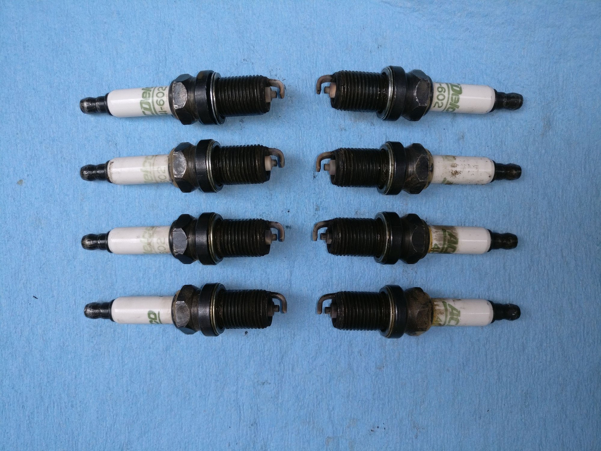

Just got my D/S plugs out, and they look fine to me. One thing I noticed is that they're a very cold plug--Delco 41-602--which is as cold as Delco's scale goes.
Edit:
Got the P/S plugs out, they look fine to my untrained eye too. Although do the plugs overall look a bit dark for just 1400 miles?
Passenger side plugs on the right

Since the plugs were the wrong heat range, I decided to change to the plugs suggested by AFR (Autolite 3923). That actually seems to have helped; my last datalog (where I was using my full-timing tune) showed just 13 knock counts in the same period as the rest. That may have just been due to the cold engine, though.
It seems the majority of the knock counts occur shortly after I drop to cruise after a period of hard acceleration.
