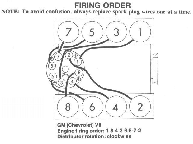

So I have my damper index wheel on the damper and I need to know the pistons at TDC at 0, 90, 180, and 270. (clockwise rotation facing damper)
From the firing order:
I know 1 is at TDC at 0 degrees, would 6 be also?
So this is what I think:
0 deg: 1 and 6
90 deg: 5 and 8
180 deg: 4 and 7
270 deg: 2 and 3

Re: Finding TDC for all pistons so I can do rope method for valve stem seal replaceme
You are correct: #1 & #6 come to TDC together.
Line up the timing mark. At that point, #1 & #6 are at TDC. Do those 4 valves.
Turn the crank 90°. The next ones in the firing order, #8 & #5, are now at TDC. Do those 4 valves.
Turn the crank 90°. ...
1 6
8 5
4 7
3 2
Looks kinda like the firing order split in half into 2 columns, no?
Pretty straightforward, really.
