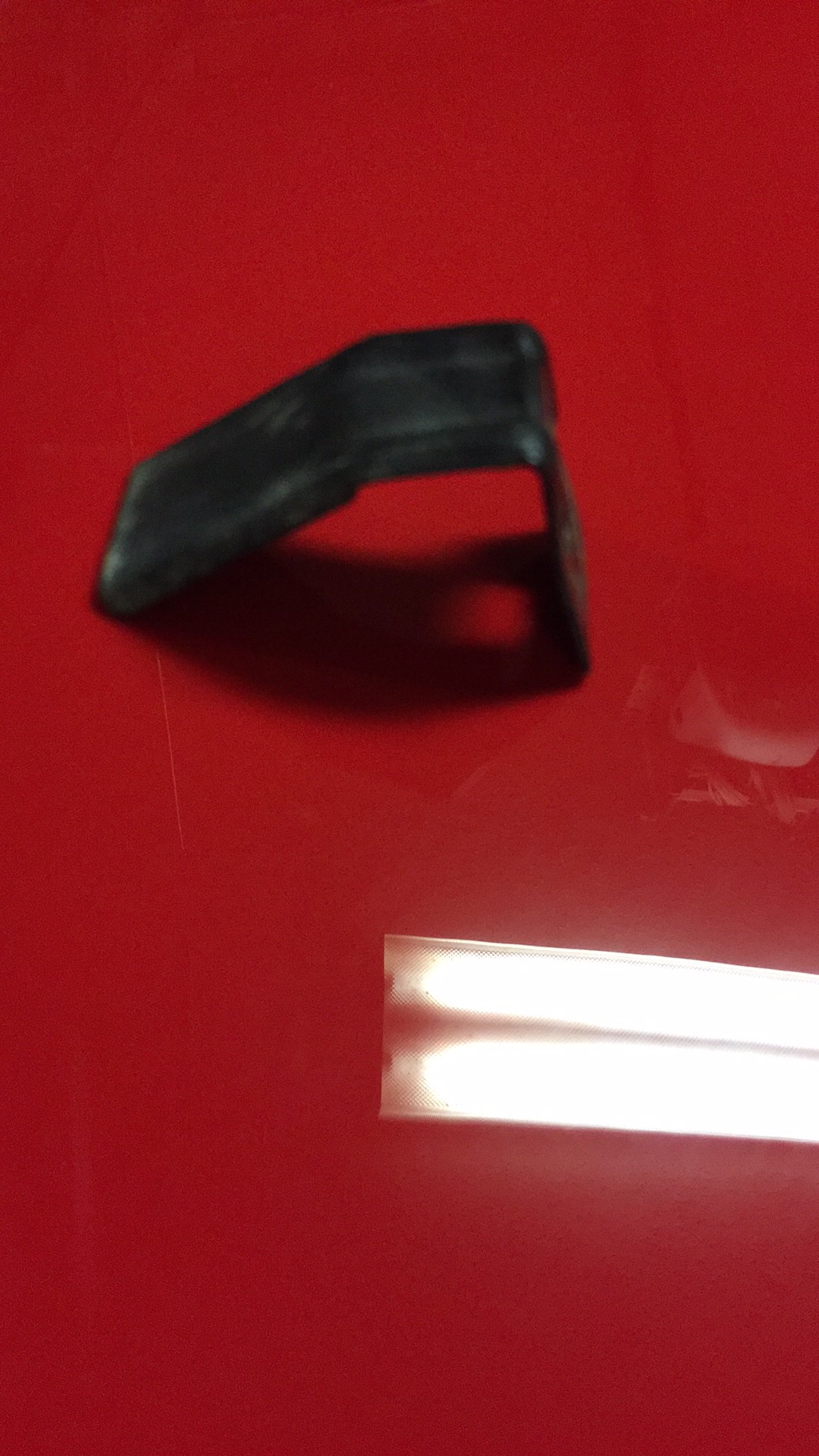

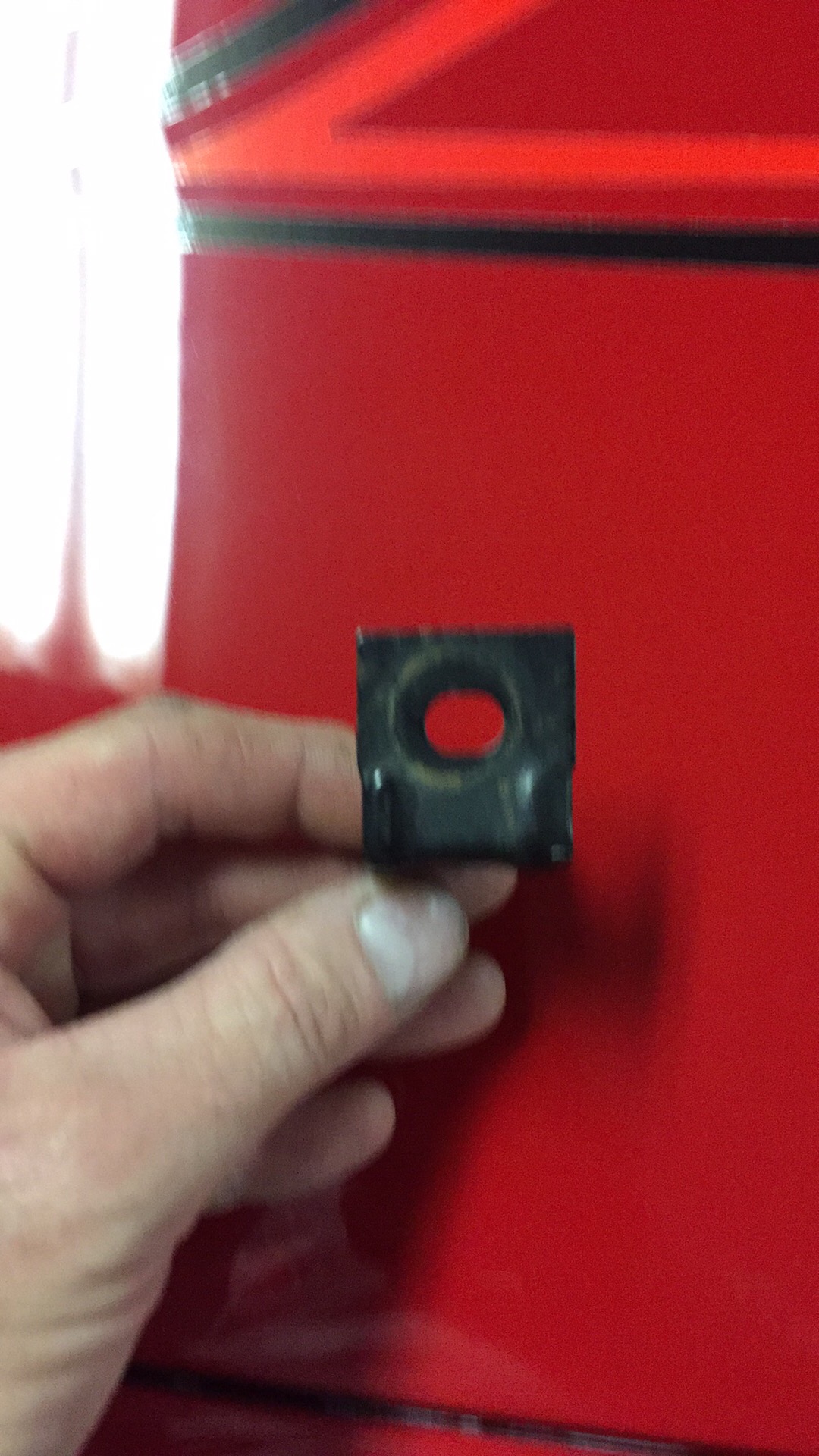

I was wondering if anybody could help me with the location of this bracket. Came out of the engine bay in a 1987 Firebird with the 2.8 L V6… I forgot to take a picture before I removed it, and now that the car is painted, there is no marks to remind me of where it went…

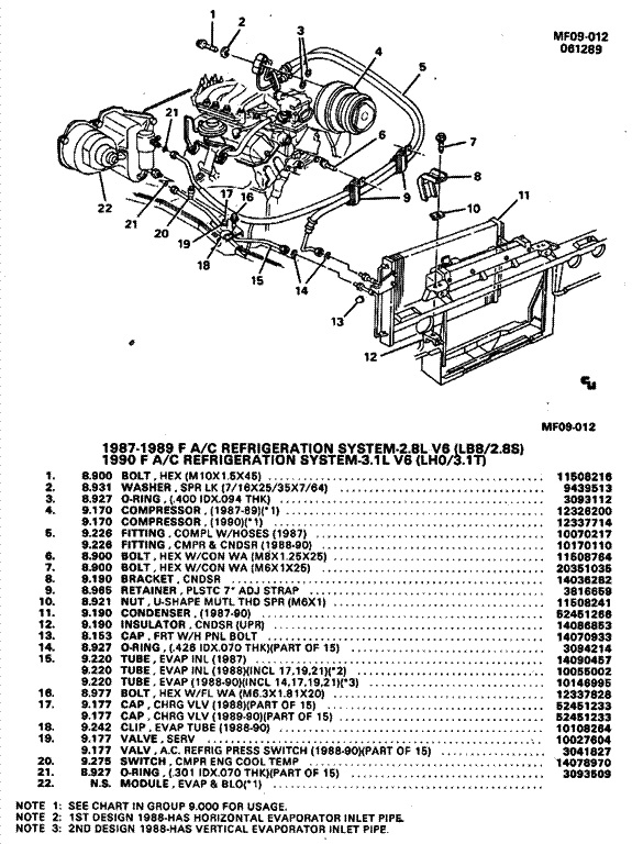

Condenser anchor, IIRC.
#8 in the diagram.
