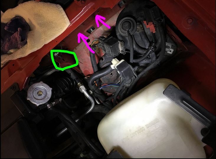

Putting things back together and cannot figure out the configuration of parts/electrical items. Hoping someone can post pictures of the canister/air box/wiring routing area so I can piece everything together and place them back to the correct locations. Specifically looking at the two electrical components and the bracket. Thanks!

Well, the bracket is upside down in the picture. The two holes closest to the strut tower line up with and use 2 of the bolts that retain the upper rad fan shroud. The plastic box/silencer sits in the bracket with a couple cheesy screws to retain the box to the bracket. Goofy 45" plastic tube goes from the MAF (between the box and elbow) to the side of the filter can.
The two relays should mount to the flange at the side of the radiator, or the rad support under the flange sorta by where the headlight grounds are located. Sometimes they're held in with plastic push pins, other times they're mounted with 7mm head head self tappers.

Green box is where the relays probably mount. Pink arrows are where the headlight grounds would normally be. Not sure what the non-original ground bolt is about, but it's not normally there. If that's the headlight ground it should be over by the pink arrows under the lip, anchored with a self tapper and a star washer.

That bracket had me baffled. I was able to get everything back together. Thanks for the info!
