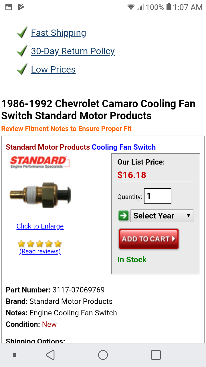

I removed this sensor from the bottom hole that I highlighted red.

That's a fan switch. It belongs in the head, if anywhere. NOT in the block. Somebody efffed up your sh...tuff.
You need something else to go in the coolant drain port down near the oil pan. It'll be called a KNOCK SENSOR. It'll look somewhat different from that.
