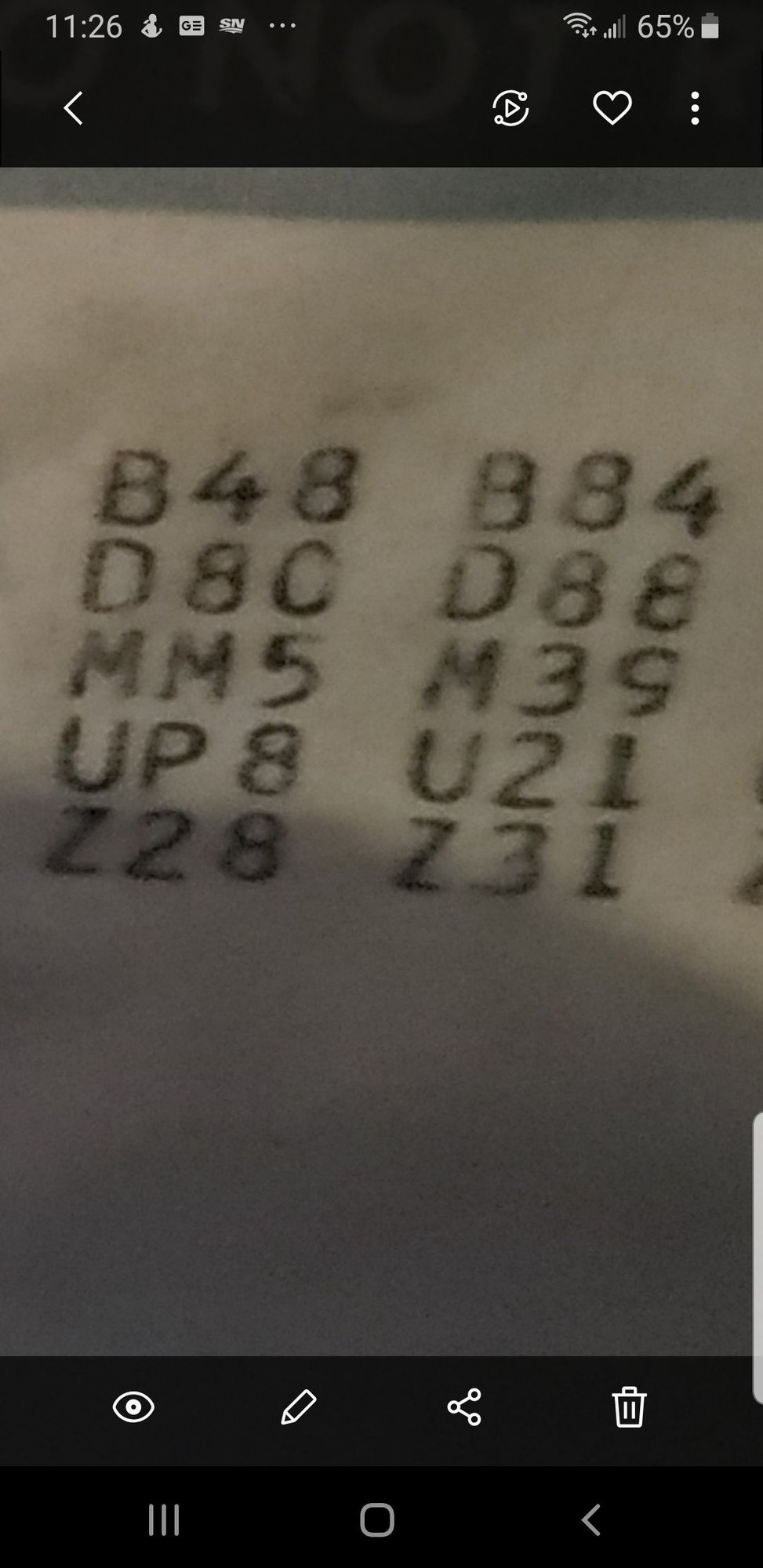

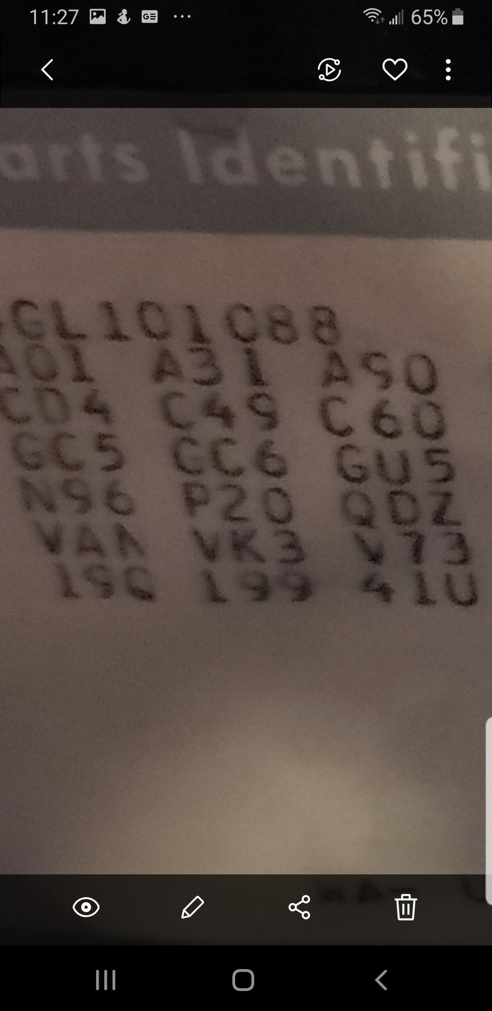

I have done a few searches on this question, but... is there a way via the vin or rpo codes to determine if my 86 was originally a manual or automatic tranny? It's an ifp87 via the vin, and Lg4 on the rpo list, but I see no listing for the original axle or transmission set up.

Use the RPO codes. The sticker is inside the center armrest cubby.

I have the rpo codes but for some reason I cant find the transmission or axle.

Axle is in the G codes. Transmission in the Ms.
I can't
make heads or tails of it but I'll try posting pics of what u refer to.

If I'm not mistaken,
MM5 signifies manual parts like console, pedals etc. etc.
M39 is the actual manual transmission
GU5 is 3.23 gear IF you have a manual. -I think.
G80 would mean posi, but I don't see it listed.
Not 100% sure about how the different gears translate to different RPOs across the different years and options etc. etc, but I'm 99% sure about the MM5, so to answer the original question, it appears your car had a manual.
