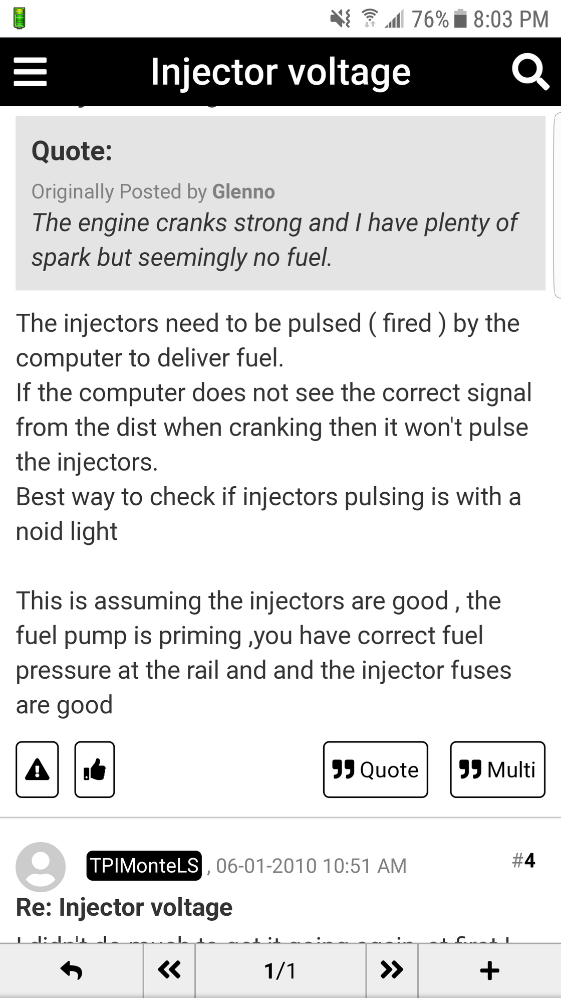

So the icm only controls spark not fuel injector firing ??
I have spark
the only thing that control's fuel inj firing is the ecu ??
I thought a guy online told me the icm did both
