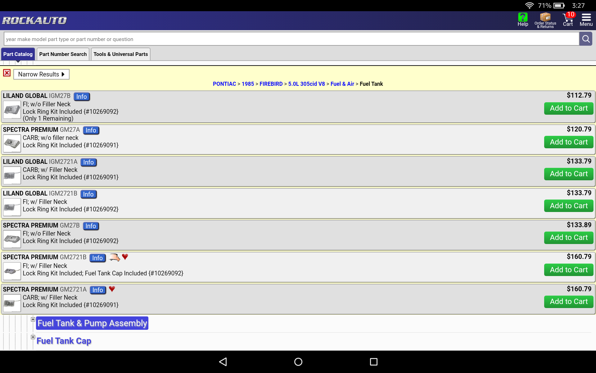

Where are you looking on Rock Auto? Got a screen shot of the listings in question?
To the best of my knowledge, all the replacement tanks are the same. You have the choice of with or without the filler neck, and that's it. If you're seeing choices beyond that, you may be seeing tanks with different pumps installed for different applications. But without seeing what you're seeing, it's hard for anyone else to tell you why one is different from another.
GM used a few different tanks. They're all the same physical size, but the sending unit is different depending on application. The best baffled tanks showed up toward the end of the 80's and were standard in nearly everything by 91-92. You might not be able to replicate that setup with an aftermarket tank, but it's not too hard to find a 91-92 V6 or TPI car to salvage the tank. The 'dual' late TPI/V6 style pickup is available from Rock Auto, it's the long sock with the pump connection in the middle, AC Delco and Delphi both offer them.

Here is a screenshot of the RA page showing carb and FI tanks with and without filled necks.

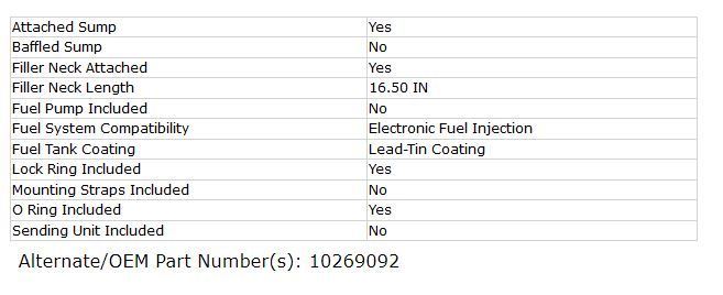

OK, If you click the "INFO" button on the carb and FI tanks, and compare the charts, the difference is the FI tanks have an "attached sump", whatever they mean by that.
