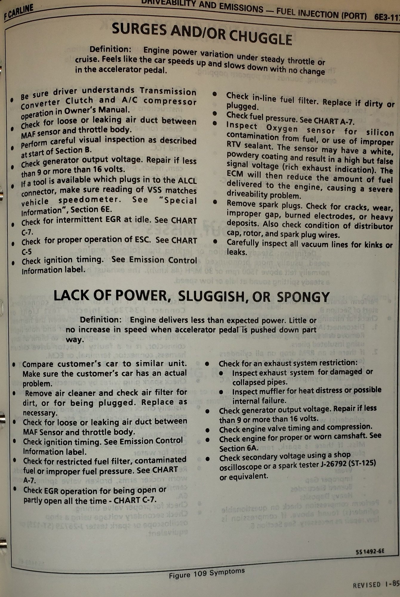

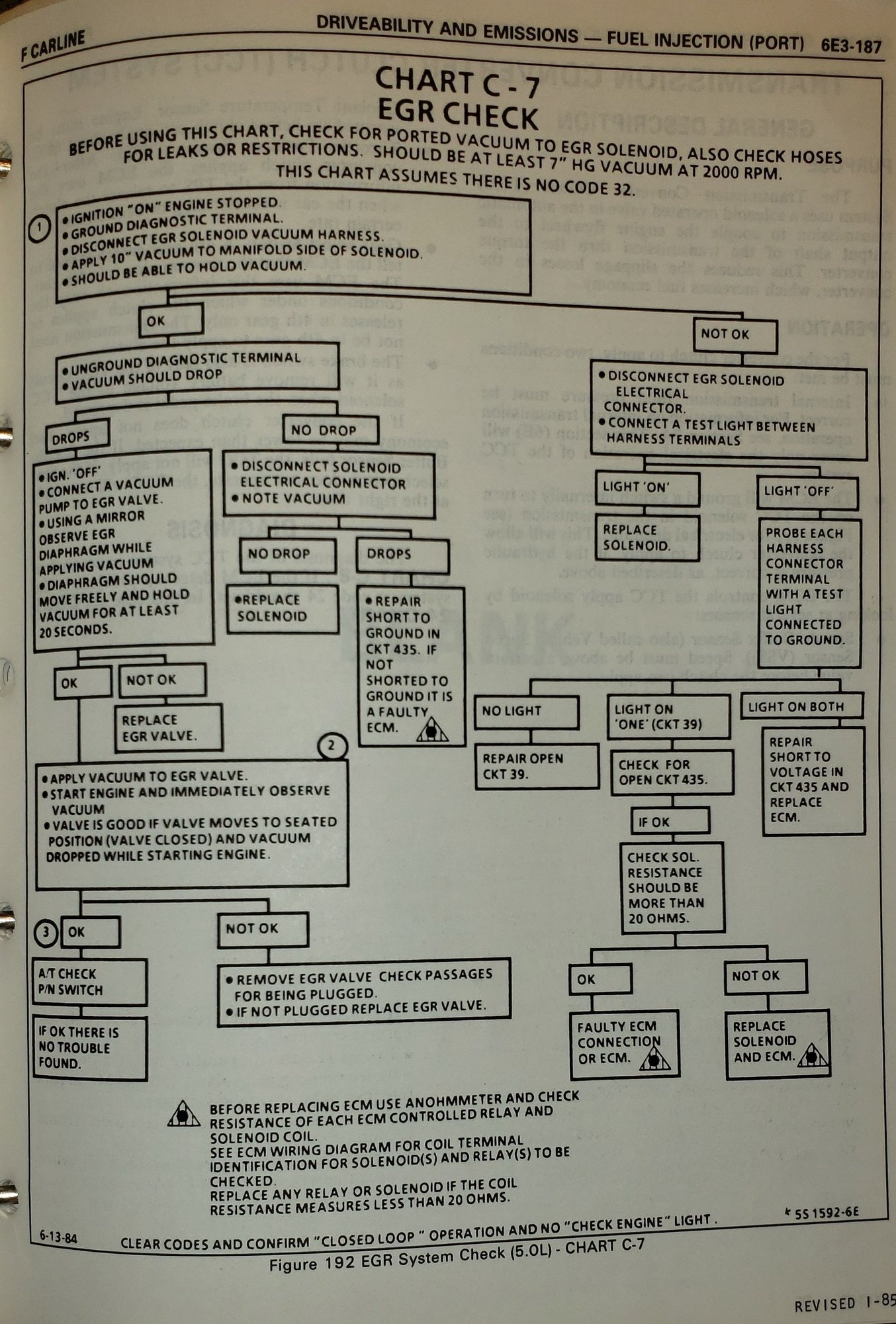

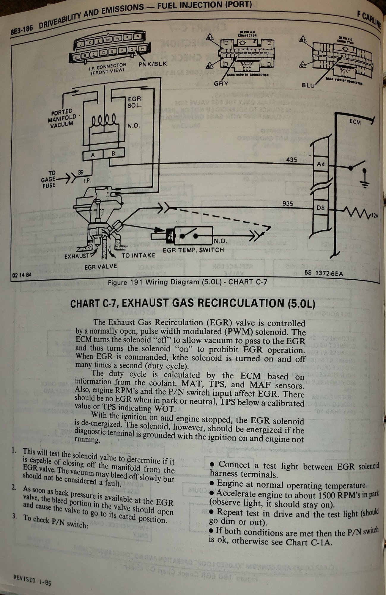

  3. Regarding EGR, the EGR valve has an internal valve that is sensitive to backpressure and it can become sticky or clogged with carbon deposits. The valve can not respond properly or hang and not close tight. I'll attach the service manual pages, test routines are complex.
Beyond that are still many possibilities. I'll also attach the troubleshooting chart from the service manual for surge.
