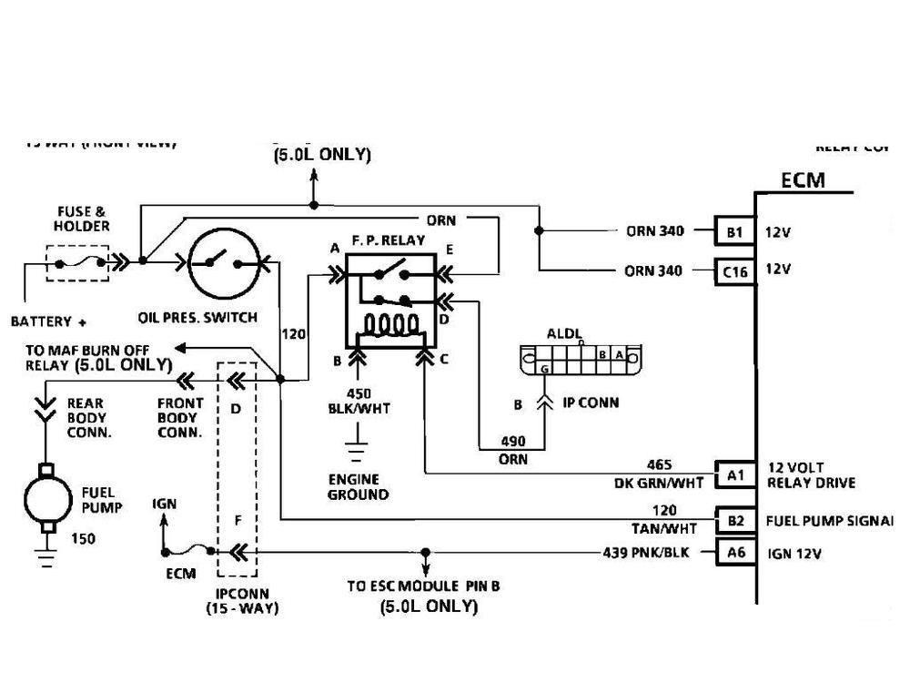

What's the fuel pressure cold when you turn on the key only? Could be a bad fuel pump relay and the pump isn't getting power till the oil pressure switch comes in. See diagram. Check your pressure stone cold and test your relay.

I can hear the pump prime before I turn the engine over, but I'm not sure what the pressure is. I'll check it today. Thanks for the diagram btw

It's not impossible, but unlikely. As soon as the ECM detects distributor pulses (even from cranking) it will energize the fuel pump relay. I might be more suspicious of the FPR or something else bleeding off rail pressure too quickly.

If the pressure didn't fully raise up on the first key turn then I was going to question the hose (or damper) that's between the pump and the fuel line of the sending unit. The oil pressure information was the only reason I gave the diagram and questioned the relay.
