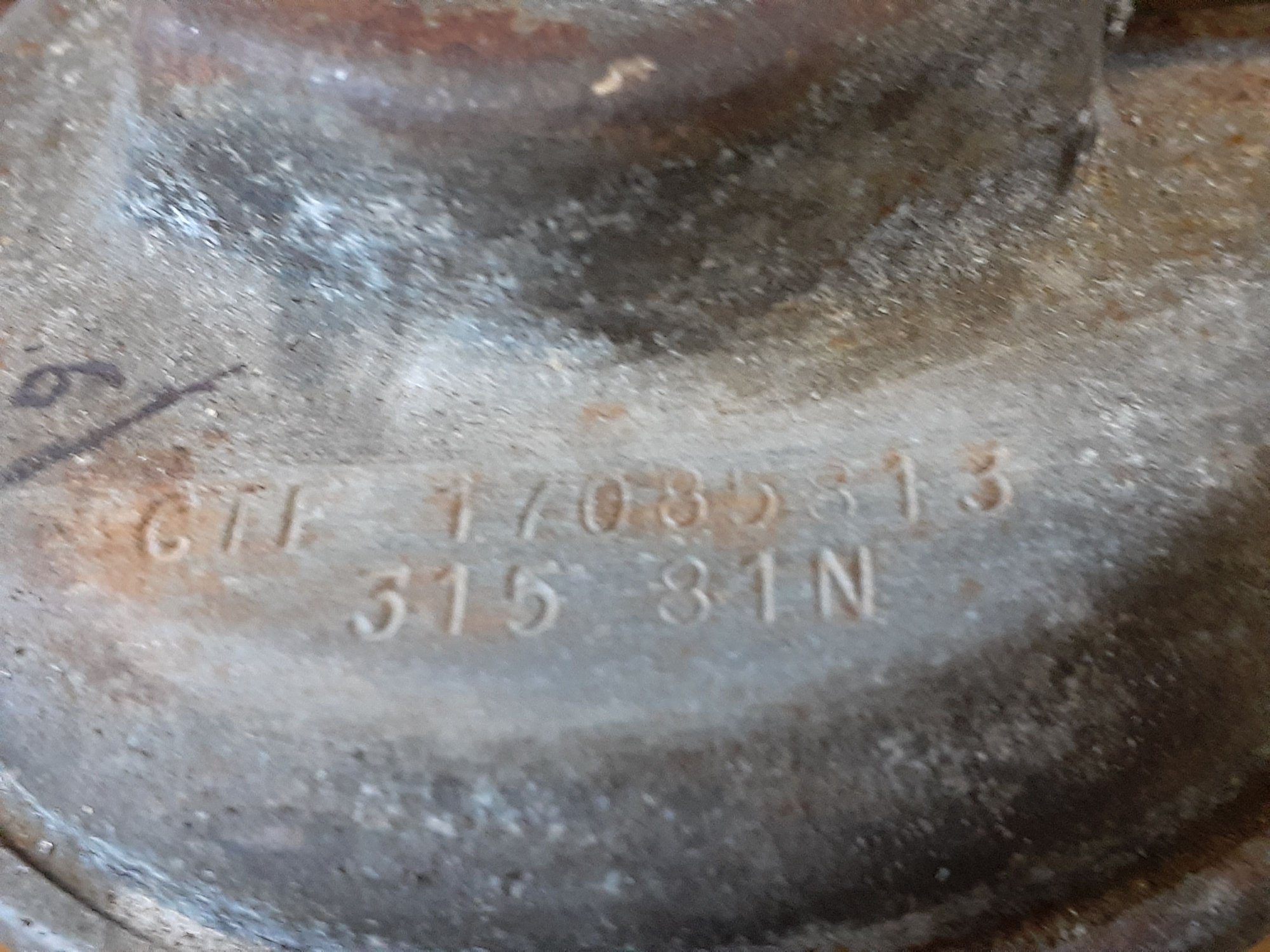

You should be able to operate the valve by sucking on it. It sounds like yours doesn't work. This was the part number on mine:
I replaced it with a Standard Motor Products EGV393 from RockAuto because I couldn't find an oem one, it seems to be working. According to my datalogger the engine has requested egr and I didn't notice anything when it did, anyway.
