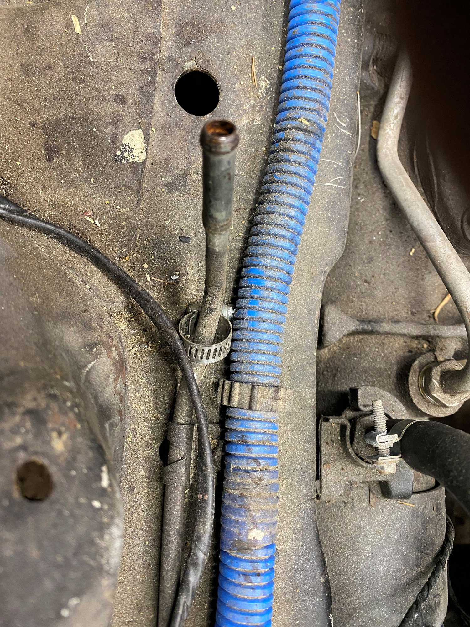

What Type of End is this
Can anyone identify what type of end this is? Pretty sure it is not a push connect style end but has a look of a gm fuel line. It is on the Vapor return line for my 83 Camaro Z28. The line is rusted and I want to replace it with a stainless steel line nut I would not mind keeping this style end to prevent the hose from pulling off / leaking.

Re: What Type of End is this
Flare It Connects To The Tank Pressure Control Valve With A Rubber Hose And Spring Clamps
