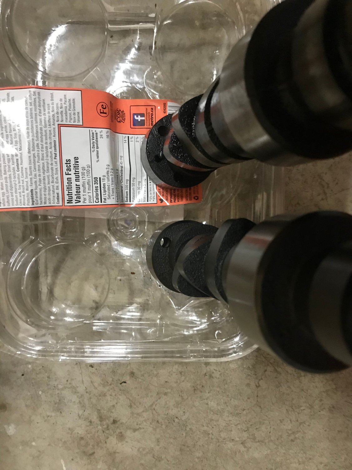

LG4 peanut on the top, 420/443 112 lsa on bottom. not a big cam by any stretch, but by comparison you can see the difference with the naked eye. I choose it so I could run a mild/stock spring with the rotators and reduce cost of the swap.
If you’re going through the process you may as well go as big as is reasonable - much of that is related to the cylinder head - and if your lg4 has the 416 heads Sofa’s recommended cam is the best performer.
There are lots of “extras” and mightaswells in the process: intake, water pump, rockers, pushrods, spendy break in oil, paint, gaskets oh my.
