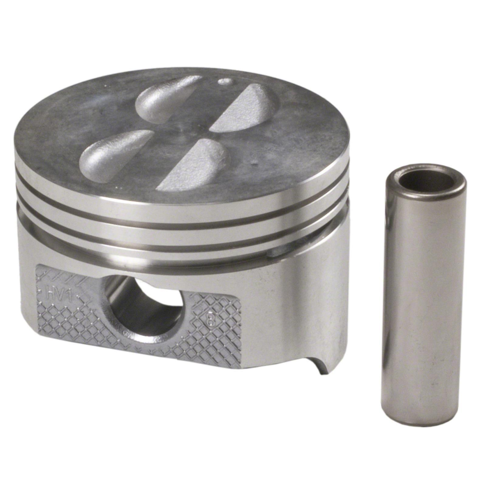

Here's what my pistons look like. You can tell me what you think it is

Just talked with the original owner and he told me it's a bone stock LG4. I have not looked up the heads ( they arent home) but its possibly the stock ones. What ones i don't know but they haven't been changed

NOT flat tops. Those are dished.
Below is a flat top.
