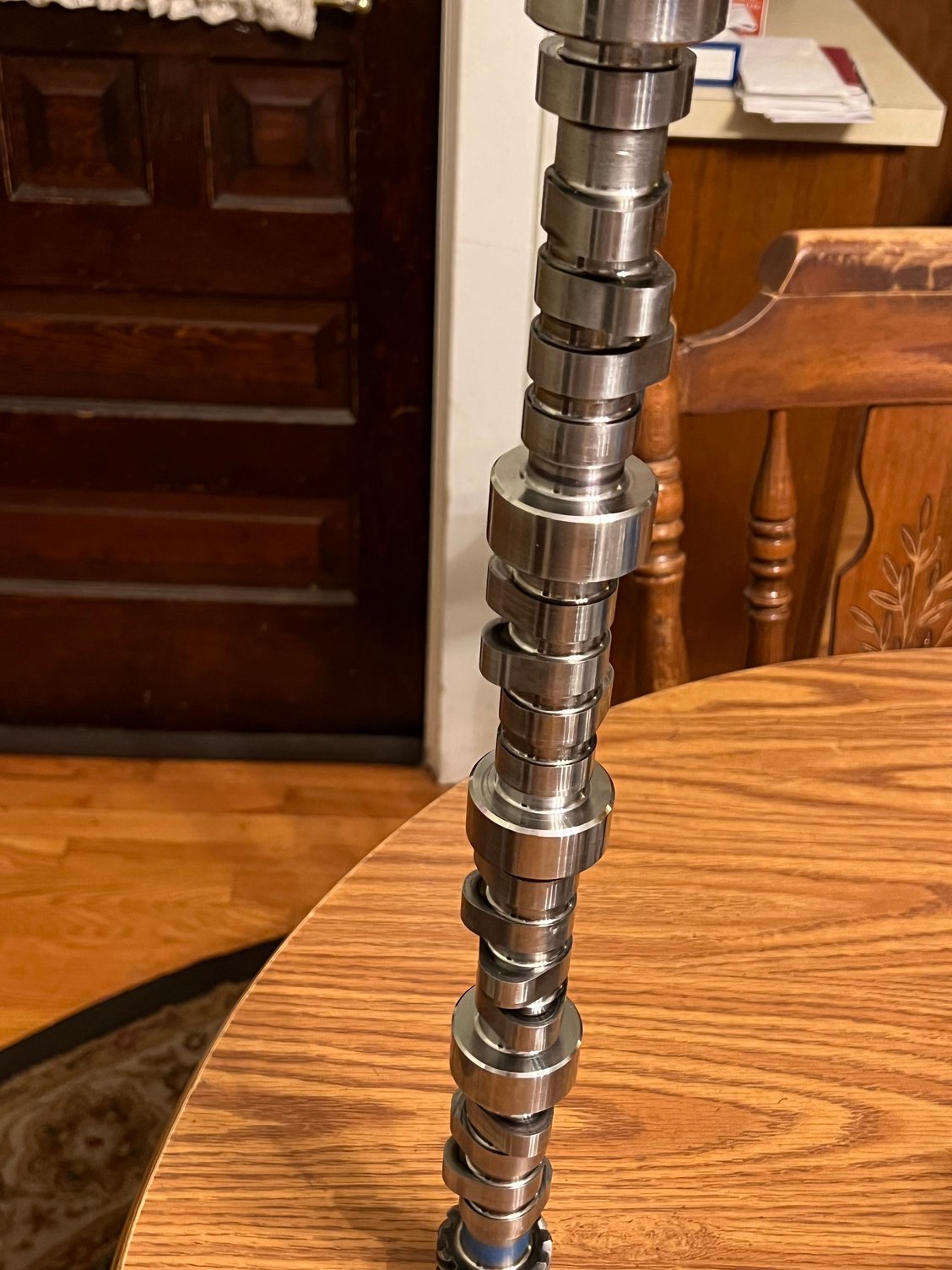

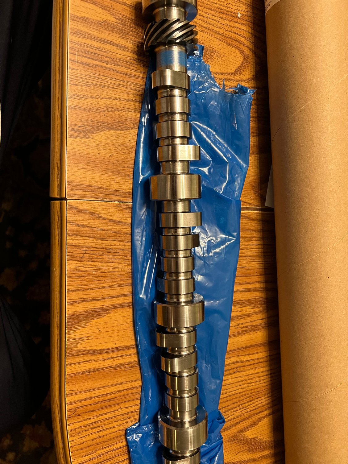

Lastly, I recall that every gm sbc that used these billet roller cams almost always had severely worn distributor gears. I even recall that my 97 Silverado had a really worn gear when I pulled the distributor . It seems that these factory gm cams cut the gear out of the solid billet slabs in which the cams are made of. The speed pro and the melling I bought appear to have a pressed on iron gear. Here are some pics of the ramjet cam

Not a fan of that cam at all. I had a 96 LT4 cam in a low compression 1-ton 350 TBI with 1.6 rockers. Very strong runner. 255 hp and 315 tq at the tires with stock swirl ports and 8.75:1 compression.
Ramjet cam is a gutless wonder.

Distributor gear problem was from GMs lousy quality control on the actual distributor gear itself. Much like the intake gaskets, exhaust manifolds and spider system.
