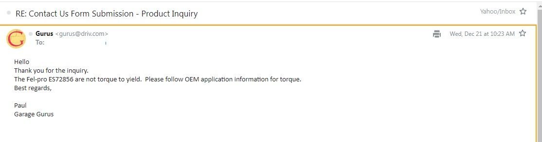

FYI i used a set of Jegs head bolts with thread sealer and torqued to 70 on my C3. Then pulled the heads with little run time about half a year later due to the M-shop getting all the exh guides too small. I cleaned up and plan to reuse those bolts.
Also I bought a 96 4x4 Sierra with a vortec 350 and plan to reuse those bolts as well, tho I'm not sure if the engine or trans was orig as their was signs someone has been in there. I considered making a vid testing those bolts, maybe torque and remove them 5-10 times but for the amount of work and little views it'd get, meh I don't care enough.
I once asked ARP how many times their bolts could be reused and their answer was as long as they are not damaged.
Second reply to my other email, same answer.

Oh and my project truck BUCK has new Fel-Pro head bolts that I'll reuse someday, was gonna use em on diff vortec heads with some Pioneer head bolt washers I got But now gonna get a set of Summit heads. So think i'll use those jegs bolts for that, if they look like the fit is good. We'll see when I get them.

Oh AND.... LOL I plan to reuse the bolts from this crate engine I tore down. Ok I think that is all LOL
