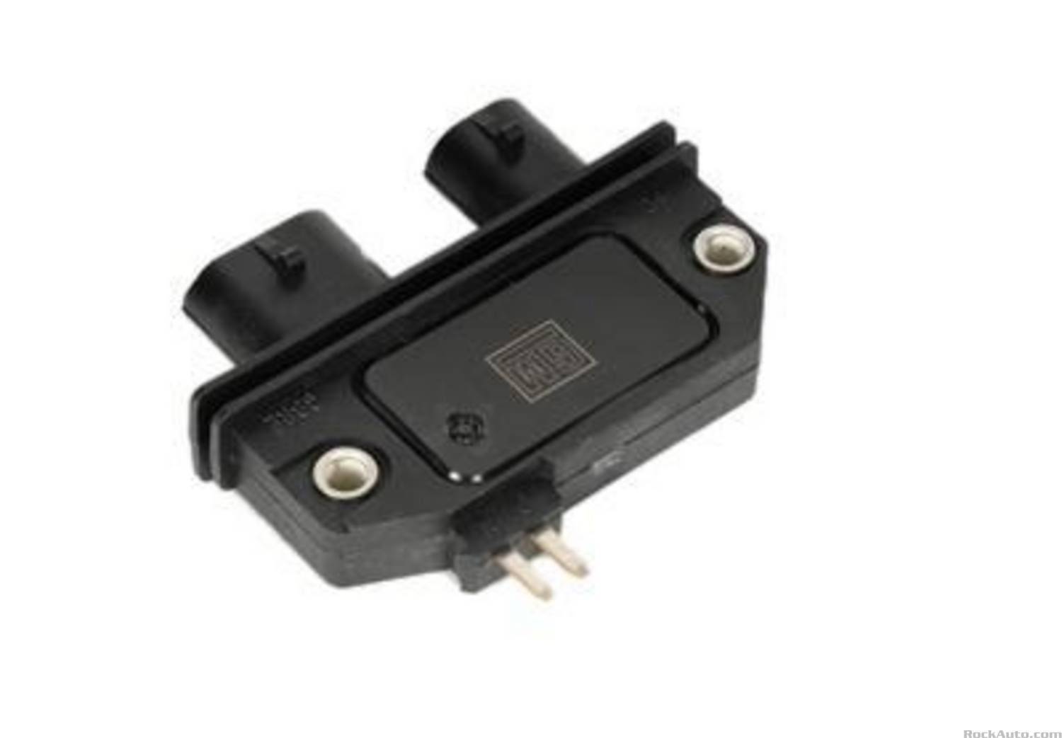

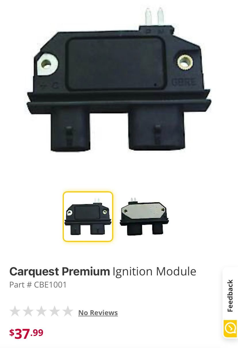

My '91 did that occasionally 2 yrs ago. I replaced the ignition module with a quality AC Delco replacement, so far so good. Never buy an ACCEL brand module, you will be left stranded eventually.
