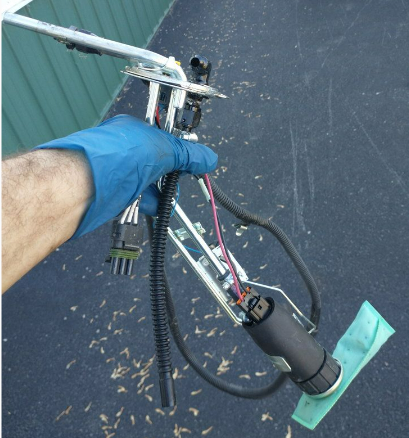

I recently put a walbro 255 in my 88 tank. Pretty easy. Fit right in the factory sending unit. Pulling the tank is the hardest part. There are a couple threads on here that can help.

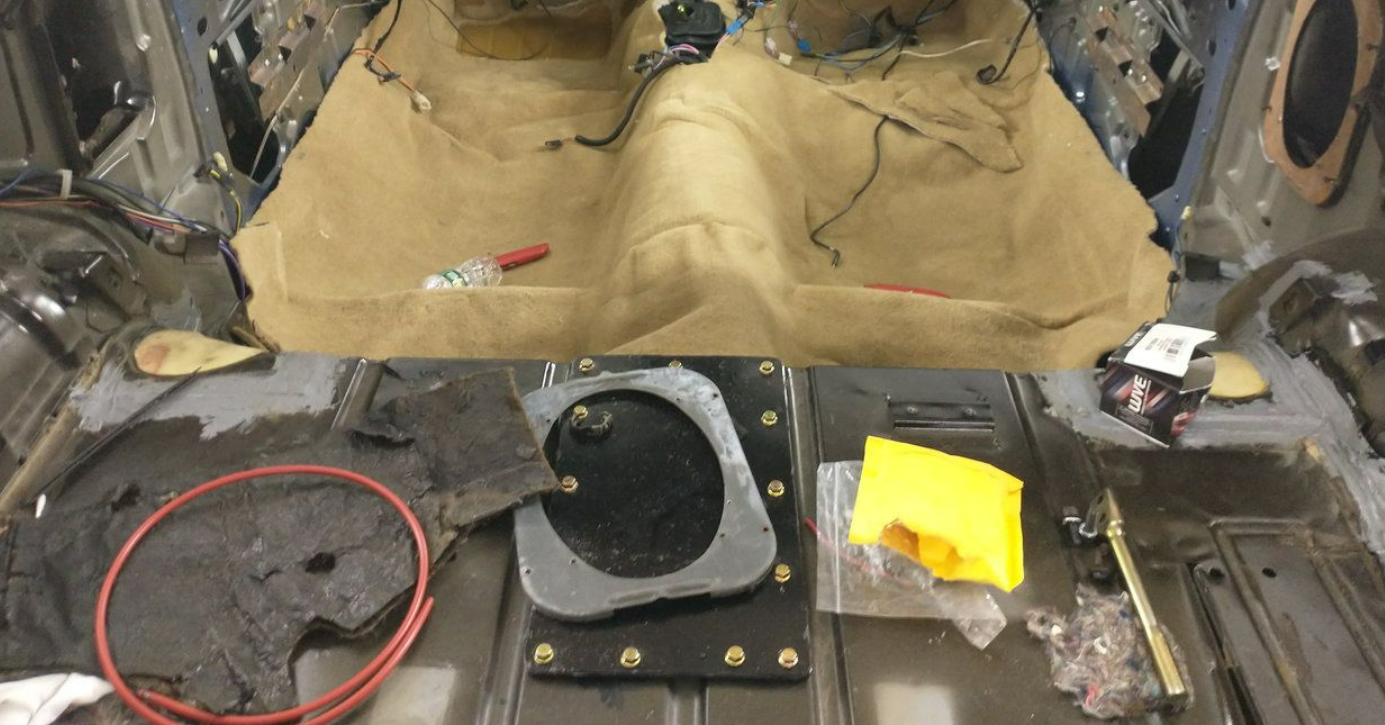

I modified a factory TPI pickup for 6AN fittings and ran 3/8 supply and return with a walboro 255lph pump. I also cut the dreaded access hole and reinforced it with 13 nutserts and a 3/16 ring and cover
