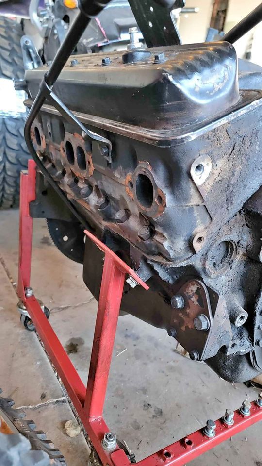

Seller states "250,000 miles, from 1994 K1500 350 small block" . Might this be an L98? It is $50 and close to my house. What block and head numbers should zi be looking for, to be an L98 ? Thanks.

Most likely not an L98, but an L05, which is a 350 TBI truck motor.

L98s only came in F-bodies and Y-bodies, so no.

Looks like a TBI motor.. A L98 will have #083 or #217 cast heads.. The tbi motors have the swirl port heads.

Thanks all, I ruled it out. At Fifty Bucks, it disappeared from facebook in a day!
