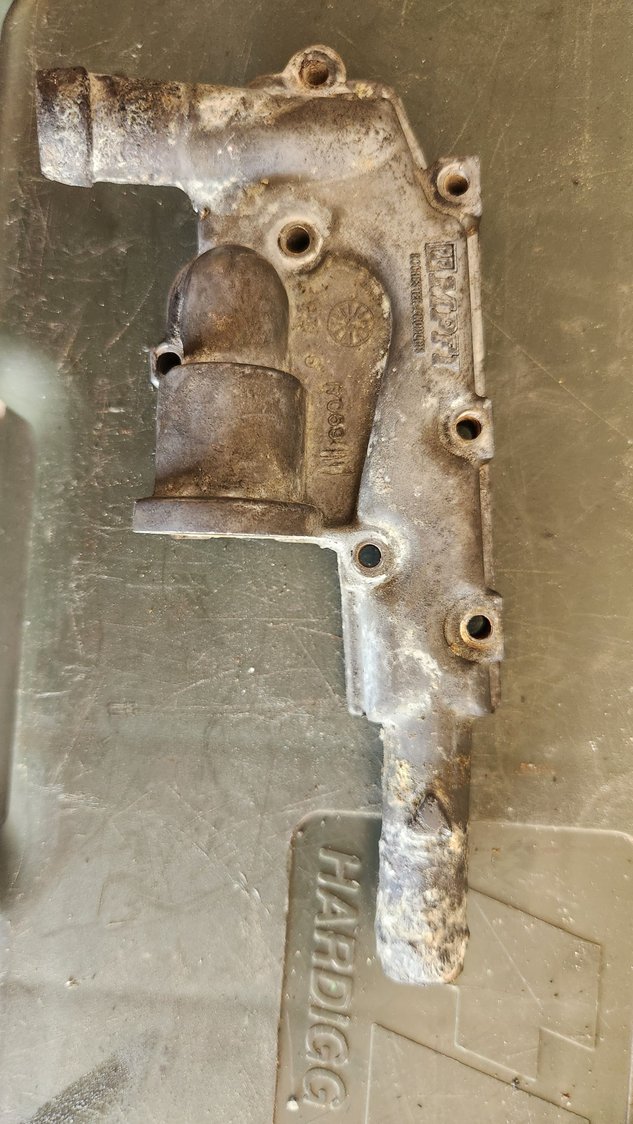

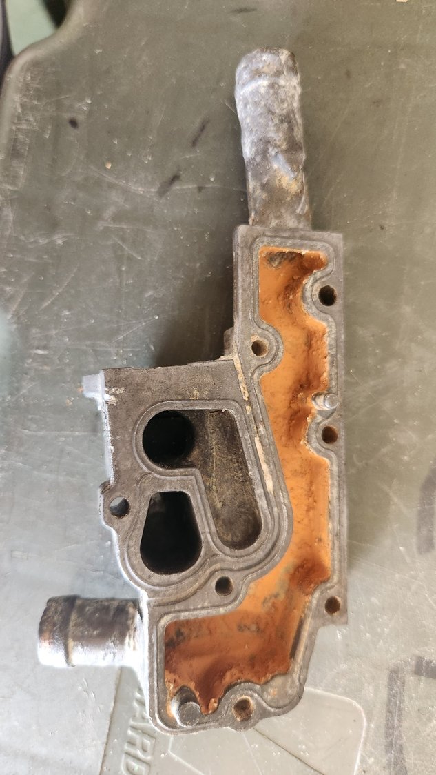

Can anyone tell me what this part is called that attaches to the bottom of the throttle body? Where can I find one?

It's the IAC housing with a passage for coolant to warm the throttle body up. Bypassing that coolant passage is a common mod to help keep the incoming air cooler.

Do you know where a new replacement part can be found?

The part is nla, tpis has a bypass one or can post in the classifieds wanted . Or cut to bypass the coolant ports and clean up looks .
