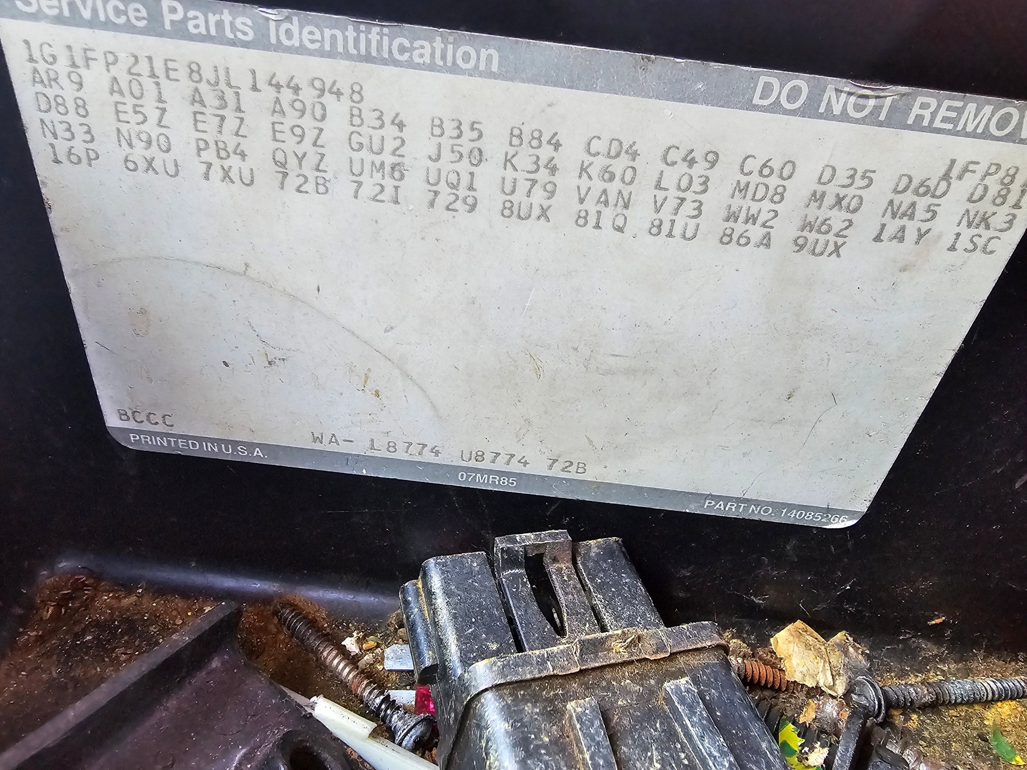

Help me decode trim please.
Is this a sport coupe or an iroc? Base 305 (L03) by the vin but no Z28 on the RPO. I'm confused, please help.

Not an IROC. Doesn't have IROC codes
2.73 gears
4 speed auto
15x7 rims

It looks to be an 88 sport coupe.
The D81 short style wing that only 88 model sport coupe had.

No B4Z or Z28.
Can't tell you if it's a Sport Coupe, for sure; butt it's most certainly NOT an IROC.
