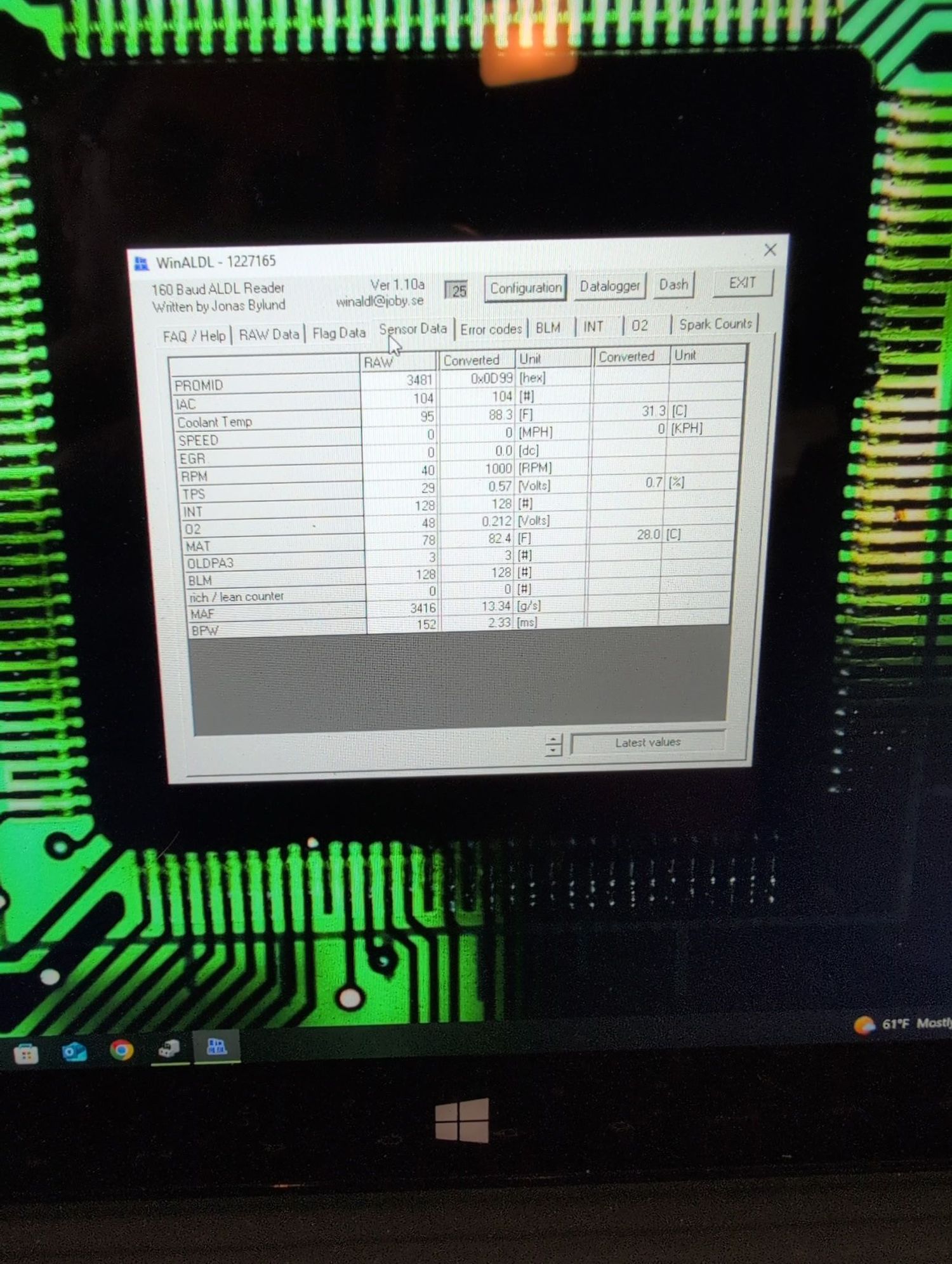

I got one of these and it works with winaldl no problem, way better than a scan tool.
https://obd2allinone.com/aldl.asp
