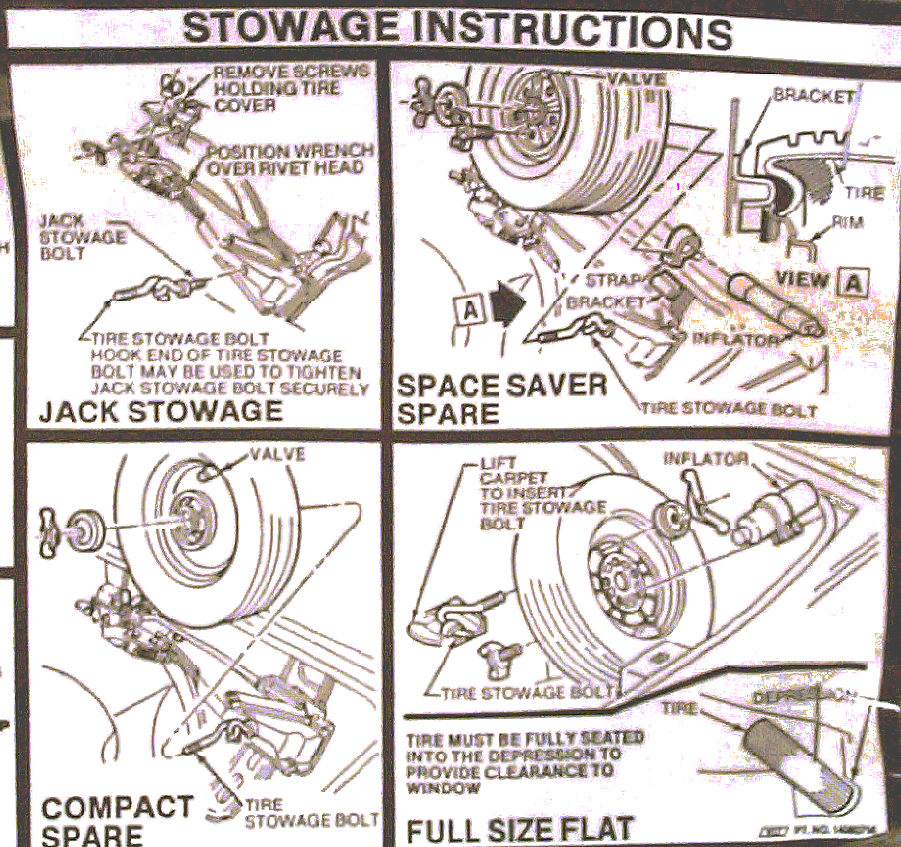

Can someone post a picture of your factory Jack and spare tire?
Mine does not have a jack and am sourcing a new setup. I'd like to stay original if possible but there are 2 different styles online and I'm not sure which is best for a 1992 RS

This is an '86-88 version - Actually two versions:
