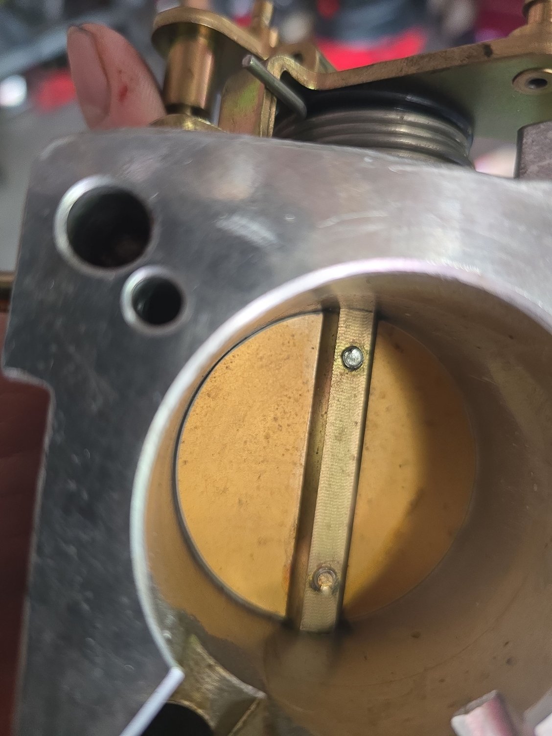

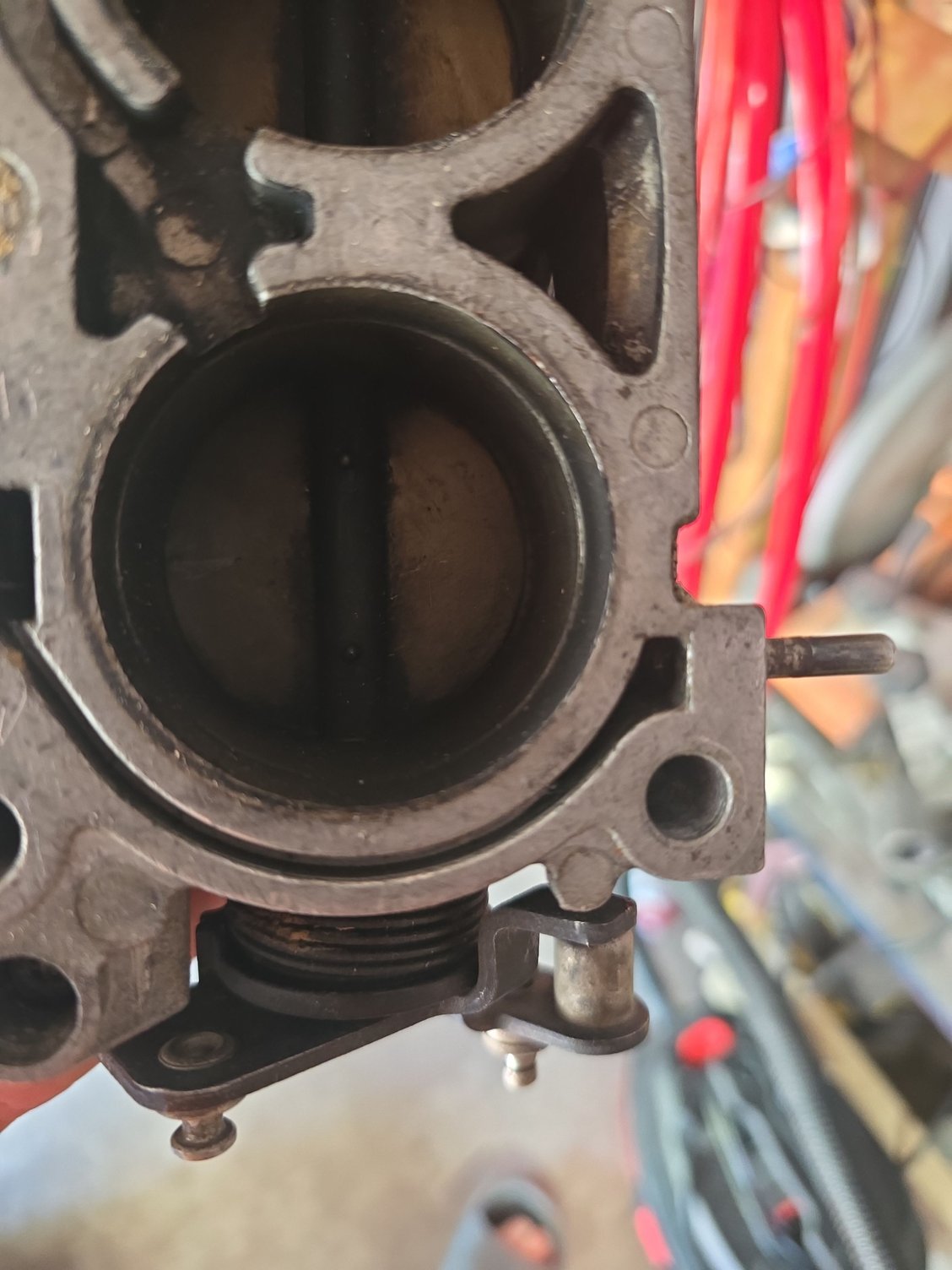

The BBK 52mm. This was the problem. The EVAP is supposed to use ported vacuum off the TB. Per the manual the system should get 15Hg of vacuum. The BBK Port on the bottom of the TB had 0. At most 0.5Hg. it actually was producing around 0.5 positive PSI upon throttle cracks. I removed it and had a look. It's a joke of a setup. That first pic is the stock TB. That large machined groove is the ported vacuum source. The BBK has that small hole under the throttle blade. Maybe 1/4 the size of the stock TB, throttle blade hole. The BBK Port hole is about the size of a sewing needle.That is not going to provide 15Hg to two valves. There's one between the tank and canister and one on the canister splitting that vacuum source. I switched to manifold vacuum and no longer have a fuel tank pressure issue. What a nice waste of time that was. Not sure how BBK managed to eF that up.

There's another big difference between stock and the BBK. The BBK bleed port is on the bottom, around the 4 o'clock position when looking at the TB. It's also right at the Blade closed point. When the blade opens it goes backwards and the port is now in front of the blade. GM's is at the 12 o'clock position and we'll back of the throttle blade. The blade opens forward and away from the port. I believe the BBK's smaller port is in a bad spot. Possibly very turbulent as I noted a pressure bump upon throttle crack. Not a vacuum. That should not be happening. Just wish I could test the stock one and see what it's doing.
