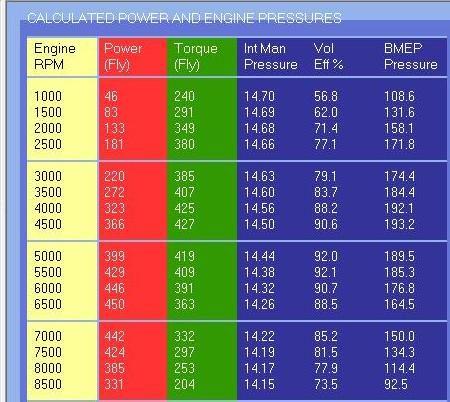

Here's a look at how 4 degrees retarded cam timing affects the power and torque. The 331 is a;ready torque limited. This adds to that.
327-4
327
That's actually not nearly as bad a drop as I was anticipating. To go to a significantly safer DCR and only lose about 10-15 ft lbs of tq I would say is worth it wouldn't you?

Keeping in mind the values from DynoSim are relative (I'll repeat that the actual numbers won't reflect real world results) I still think you'll end up with an engine that under performs down low. Now, having said that, if you were to invest in something like a Cloyes HexAjust timing set, you could mess around with cam timing even after the engine is built. It's not the easiest thing to do but not as much work as swapping head gaskets.

Yeah I have. The problem is not knowing what they would be good for to know how to market them. Also since I'm swapping from a lack luster 305 TBI motor, I'm already light years ahead of where I am now with a measly peak tq of 255. I'm thinking very seriously about just sticking the cam in there at 4* retarded and seeing how it all goes. If those simulator work ups are even remotely close I'm sure I will be ecstatic. I just hate to lose my **** on the heads. Especially not knowing where to start with what to replace them with. The Cam as we've been discussing I think I will be ordering is that Crower 00466.

I edited all of my posts. For whatever reason I had it that you were using a conventional flat top piston. When I recaluclated with a 5cc dish rather than a .5cc dome, the engine suddenly worked.
As for a 9:1 DCR...never with iron and not have to sacrifice lots of timing. With aluminum, I can't say.
