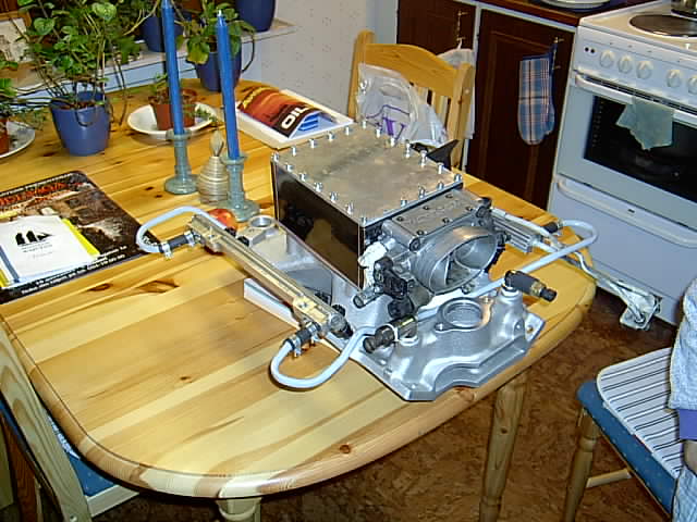

yup.
athough if i had access to the equipment, i wouldnt be keeping the stock base
id probly machine a single plane carbed intake to hold the stock injectors/fuel rail, and then make a box plenum to go on top... and mount the throttle body to it in roughly the same place as stock..
athough there is a guy on here from sweden that beat me to it.
