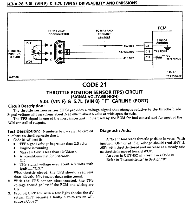

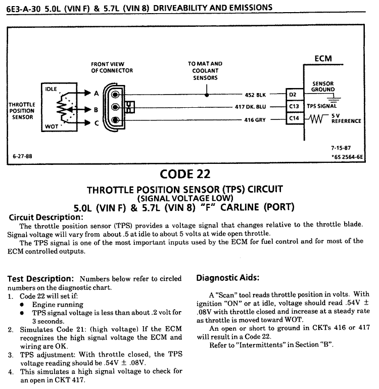

Hello,
I traced the wires back to the ecm and tested the blue wire for the tps and it still gave me the same reading throughout different points in the harness. I believe that you said it could be a bad ecm then. How can I be sure that it is the ECM?

Hello Rick,
I just had to go back and check your original post to see if I had sent you the troubleshooting chart for the TPS. I hadn't, so here it is. I will send some more info later.

page 3
