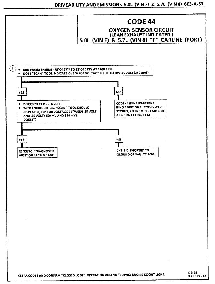

Hello RickyMonster,
Check out this chart and see if it will help you correct your problem.

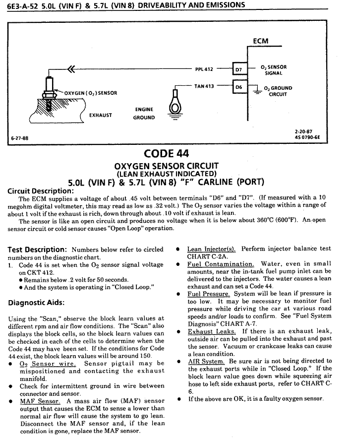

page 2
