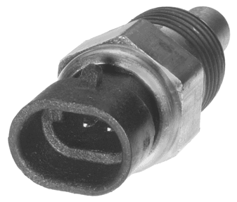

Found p# 213-928 on an acdelco website. It's the part number given for an 87.
The 213-80 number came up for an 89 350cid.
I'll try and find if I can get the 213-928 sensor here and try that.

The first number used to be a good one???
The other numbers are DELCO part numbers not GM so they wouldn't show up.
Most parts stores here would interchange from the GM number.
12146312 was listed on GMparts directs website for 87 and 92.
I don't know if that is correct for the V8.
i was typing while you were
They all pretty much look the same.
