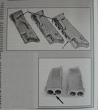

this number 14081006 should be on the bottem of the plenum.i beleive that is the part number for the 85-88 plenum.i've added a picture of the three plenums offered by GM.the one on the left is the 85-88 the middle one is the 89 and the right side is the 90-92 plenum.you can use the 89 plenum on a 85-88 car cause it still has the passage way in the front of the plenum.

That is good news. I never see the 87-88 part number for sale, p/n 10108443. I frequently see the number I listed in the first post. The 1989 number is listed as 10108486 in my IPL. However, the last time I bought parts from Chevy the counter person told me that ~1990 the parts numbering was changed on a lot of parts. Where did you get the information you show in the photo in your post.
Thanks,
Scott
